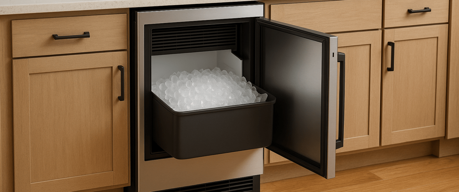

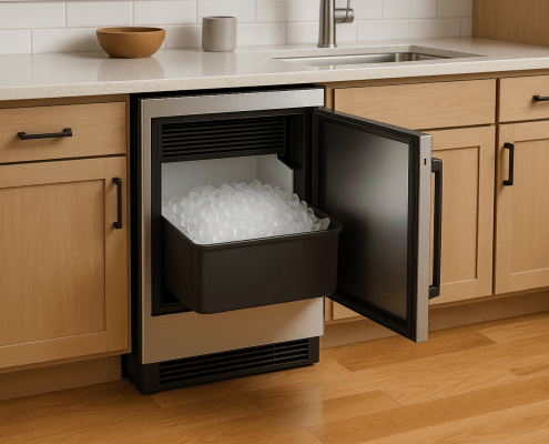

When a KitchenAid freestanding ice machine stops producing ice, drips water, or refuses to fill the reservoir, the water inlet valve is a top suspect. The good news is that this is a fix many homeowners can handle with a little patience, a multimeter, and a clear plan.
