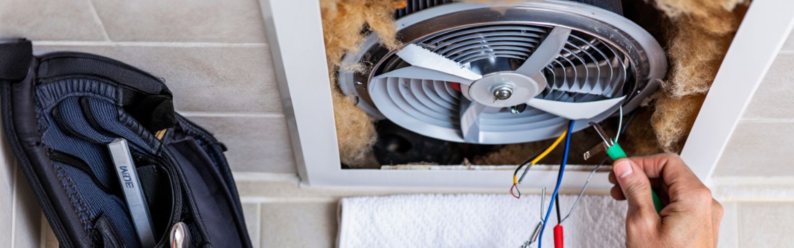

If your bathroom fan refuses to turn off, it can be pretty annoying. Whether it’s a fan with a built-in timer or a basic model, a fan that runs nonstop wastes energy and could lead to unnecessary wear. Fortunately, this is a problem you can often fix yourself with a bit of troubleshooting. We’ll walk you through the common causes for a fan that won’t shut off, and give you DIY repair tips to get your bathroom fan working properly again.

- Turn off the power: As always, start by turning off the power at the circuit breaker to ensure your safety while working on the fan.
- Remove the fan cover: Use a screwdriver to remove the cover or housing of the fan. This will give you access to the fan motor.
- Inspect the motor: Look for any visible signs of wear or damage on the motor, such as rust, scorch marks, or broken components. A motor that’s physically damaged may need to be replaced.
- Check the motor’s connections: Ensure that the motor wires are securely connected. Loose or corroded wires can prevent the motor from turning off.
- Test the motor with a multimeter: Use a multimeter to test the fan motor’s continuity. Set the multimeter to resistance (ohms) mode, and place the probes on the motor’s terminals. A reading of zero ohms indicates a short in the motor, while an infinite reading means the motor is not conducting electricity and is likely faulty.
- Test the motor’s power supply: If the motor appears undamaged but the fan still won’t turn off, check if it’s receiving power when it shouldn’t. If power is still being supplied, the motor may be receiving a constant electrical signal due to a wiring issue.
- Replace the fan motor if necessary: If the motor is found to be defective, you will need to replace it. Make sure to get a replacement motor that matches the specifications of your fan model.
- Install the new motor: Once you’ve got the new motor, install it by attaching the fan blades, securing the motor to its mounting bracket, and connecting the wires to the correct terminals.
