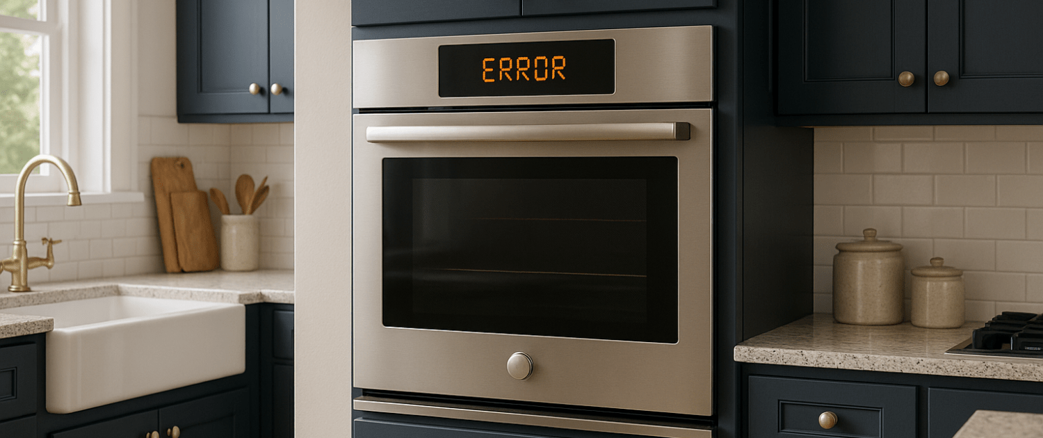

Getting an F41 or F43 error code on your Bosch oven? These fault codes indicate an issue with the motorized self-cleaning latch failing to lock or unlock properly. In this guide, we’ll cover the causes behind both the F41 and F43 Bosch oven error codes and walk through the steps to diagnose and resolve the problems.
