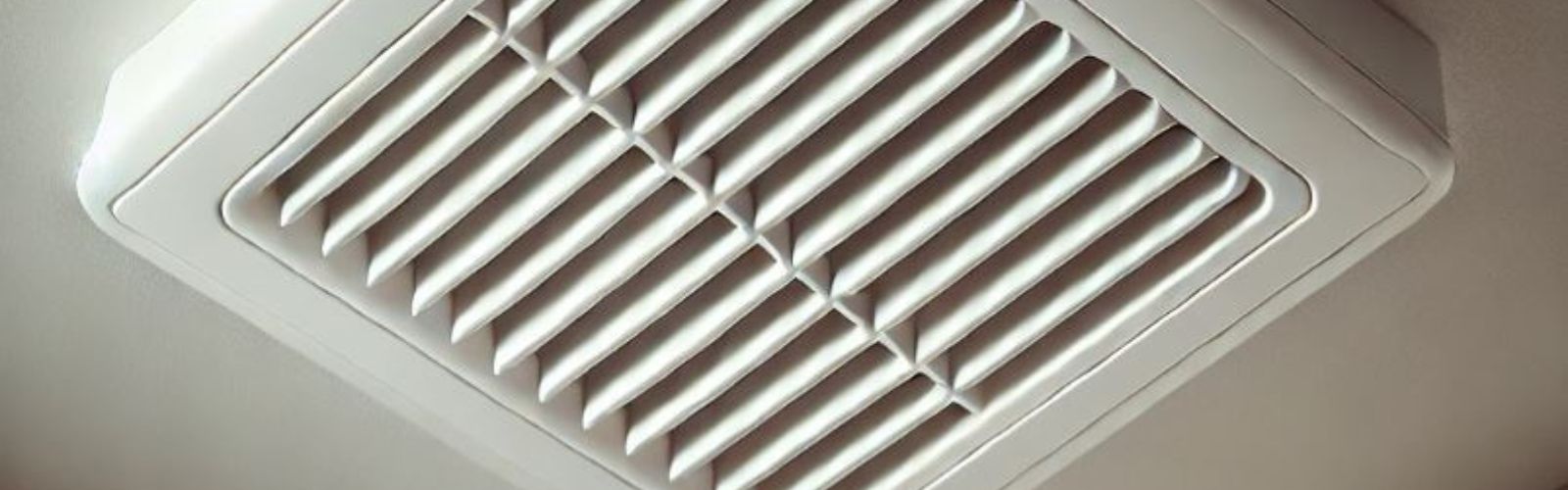

Ever noticed your bathroom feeling muggy and damp, even with the fan whirring away? Chances are, there’s a clog in your fan’s duct. Bad airflow leads to unwanted moisture, which can invite mold or mildew to the room. The good news? You can usually sort out these obstructions yourself. Let’s dive into how to spot the cause of poor airflow and fix it up for better ventilation.

Step 1: Take off the fan cover
- Shut off power to the bathroom fan at the breaker, safety first!
- Find any screws or clips holding the cover. Usually, there are a couple of screws or some metal spring clips.
- Hold the cover with one hand while you remove the screws or release the clips using your screwdriver.
- Gently pull the cover down. If there’s a light attached, carefully unplug any wires if needed.
- Now that the cover’s off, you can see the fan blades and what’s around them. Put the cover somewhere safe, you’ll need it later.
