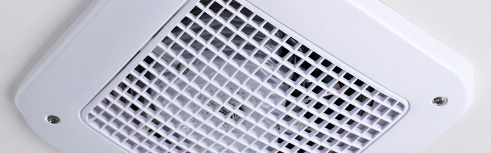

Your bathroom fan’s more important than you might think, it clears out extra moisture, kicks bad smells to the curb, and helps keep mold from forming. With a few easy DIY steps and some smart habits, you can keep it running smoothly for years. Let’s check out some practical tips to help your bathroom fan do it’s job without turning maintenance into a chore.

Get to know your bathroom fan
Your bathroom fan has two main responsibilities: it takes out the steamy air from showers and helps get rid of any bad odors. The motor spins the blades or blower wheel, creating airflow that pushes moist air out through the exhaust duct. Clearing out excess humidity stops mold and mildew from forming on your walls, ceiling, and fixtures. Since it’s working in a damp environment, the fan can collect dust, lint, and other buildup over time, especially if not cleaned regularly.
Some fans come with a heater or a light, while others just ventilate. Each type has its own setup but typically consists of several key parts, including:
- Fan blade: The rotating blades that create airflow to expel moisture and air from the bathroom.
- Motor: Powers the fan blade, making it spin to generate airflow. It is typically located inside the fan housing.
- Fan housing: The outer casing that holds all the internal parts, including the motor and fan blade. It’s typically installed in the ceiling or wall.
- Grill/grille: The cover that sits on the ceiling or wall and protects the fan while allowing air to pass through.
- Ductwork: The system of pipes or ducts that directs the expelled air from the fan to the outside of the building, often through the roof or side of the house.
- Damper: A flap or valve that prevents outside air from entering the ductwork when the fan is not in use. It also prevents drafts and insects from entering.
- Switch: The electrical part used to turn the fan on or off, which can sometimes be integrated with a light switch.
- Cap: The external cover on the end of the ductwork, typically located outside the building, to prevent rain or debris from entering.
- Wiring: The electrical parts that connect the fan motor to the power supply, allowing it to operate.
