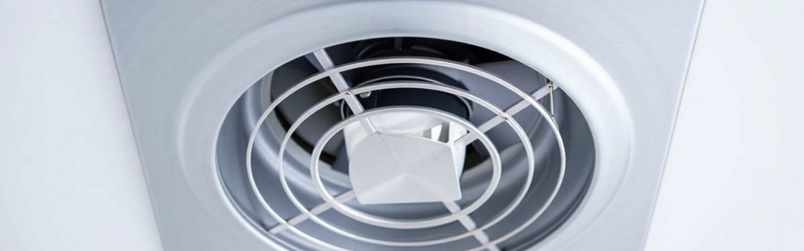

How to fix a bathroom fan that won’t turn on
Steven E / Tuesday April 1, 2025
A quiet, effective bathroom fan is key to clearing out humidity and funky smells. If it suddenly decides it won’t do a thing, you’re left with a damp restroom, and that’s definitely not ideal. Here are some steps you can run through right now to get your bathroom fan spinning again.
