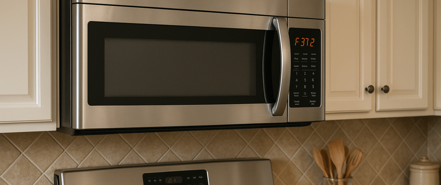

Is your Whirlpool microwave flashing the F3T2 error code and refusing to work like it should? That code usually means there’s a problem with the temperature sensor, either it’s faulty, disconnected, or reading incorrectly. The good news? It’s a fixable issue! We’ll show you how to troubleshoot the F3T2 error step by step, so you can get back to heating up your leftovers in peace.

The F3T2 error code indicates an issue with the food cavity (FC) thermistor in the Whirlpool microwave oven. The FC thermistor is a temperature sensor located in the rear of the oven cavity. It measures the temperature during convection cooking functions to ensure accurate heating. If the oven’s control board is not receiving the correct temperature readings from the FC thermistor, it will display the F3T2 error code and the convection system will not operate properly.
