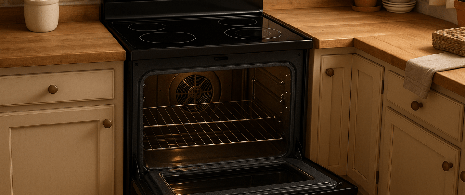

Noticing uneven baking or strange noises from your Samsung electric range? The lower convection fan motor could be failing. Here’s how to test and replace it to keep your oven running smoothly.
