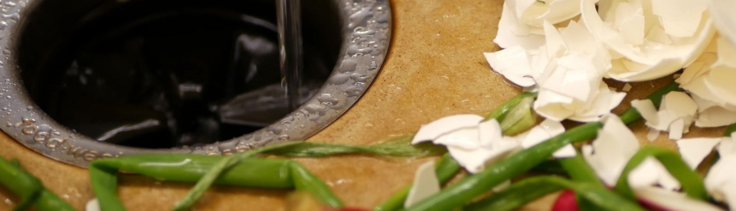

eggshells and vegetable scraps laying next to garbage disposal in kitchen sink
