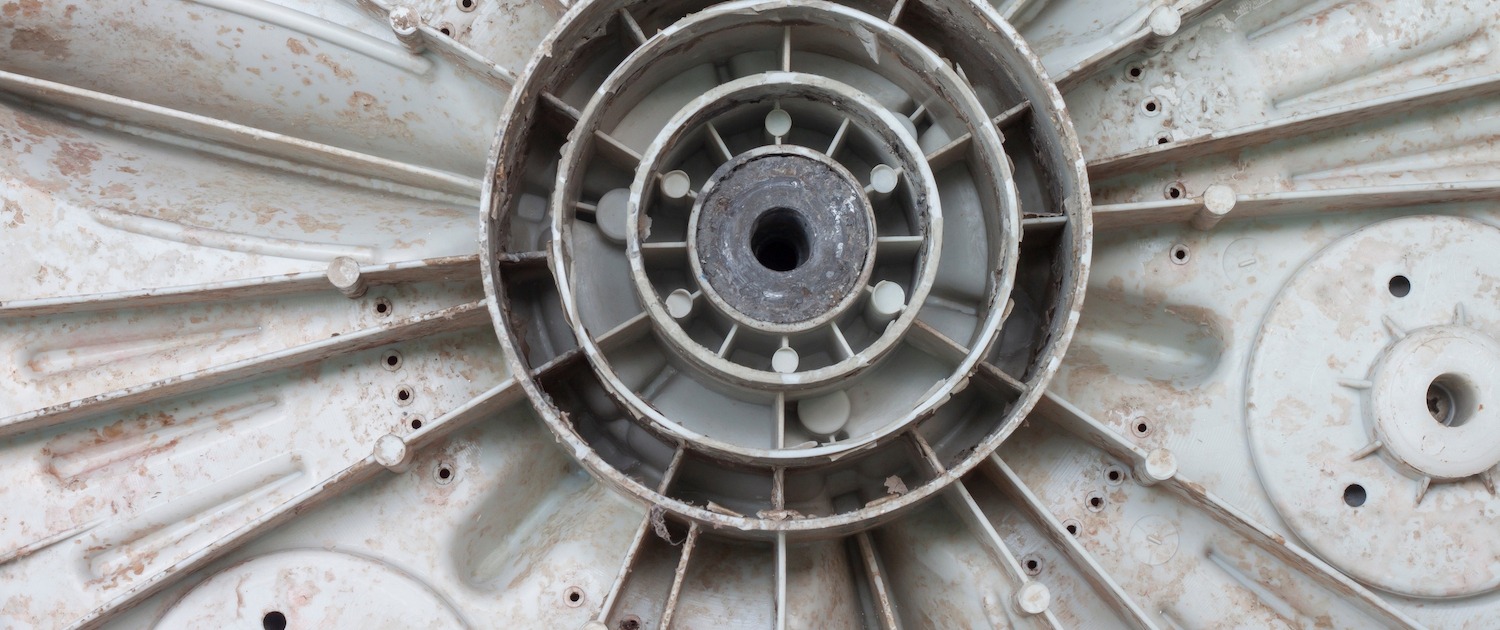

Damage to your washer’s pulsator may be as obvious as cracks or dents on the component’s surface, but breaks and other issues may not always be so plainly visible. Often, the interior of the pulsator or the splines in the central shaft can be damaged by debris slipping through the cracks – change left in pockets, for example – or through corrosion caused when too much detergent is used. On high efficiency appliances, using too much detergent can seriously damage things. To extend the life of your appliance and its components, make sure you are always using the correct amount!
If the pulsator isn’t moving, if the washer is making strange noises when it runs, or if you’re having trouble getting the washer to drain, check around the sides to see if anything is wedged in the seam. Spare change and folded up paper can get stuck in the crack between the washer and the pulsator, locking it up and stopping it from spinning. Take care when removing any debris you do find. You don’t want to damage the washer. If it’s really wedged in place, it may be easier to remove the pulsator than trying to pry whatever is stuck out.
If the seam is clear and you’re still having issues, you can also try cleaning the pulsator per your appliance’s instructions, usually with heated white vinegar. You may have to remove the pulsator to do this, so be sure to check it and the parts beneath it for signs of damage when you do. If, after cleaning, your washer still isn’t working right, it’s time to replace that pulsator.
