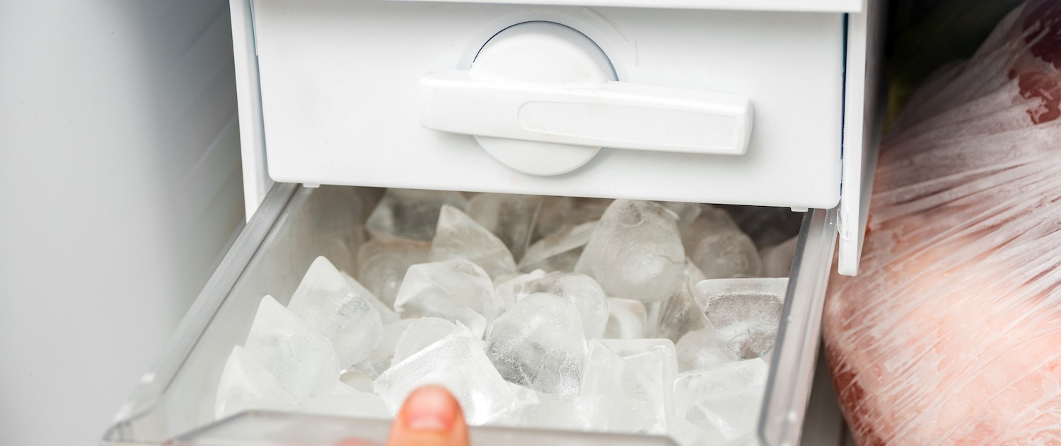

- Open up the freezer door to access the ice maker assembly and remove the ice bin. Taking the ice bin out and setting it aside will give you easier access to the assembly, making your life a whole lot easier.
You may need to lift up slightly on the bin as you pull it forward so that it clears any brackets holding it in place. If the bin is stuck because of icy build up, the best thing to do is allow your freezer to defrost. You can chip the ice away with your hand or a mallet, but might risk damaging the bin. - Loosen the mounting screws holding the ice maker in place. There should be a couple of screws holding the side of the ice maker to the interior wall of the refrigerator. Use a quarter inch nut driver to loosen, not remove, the screws.
