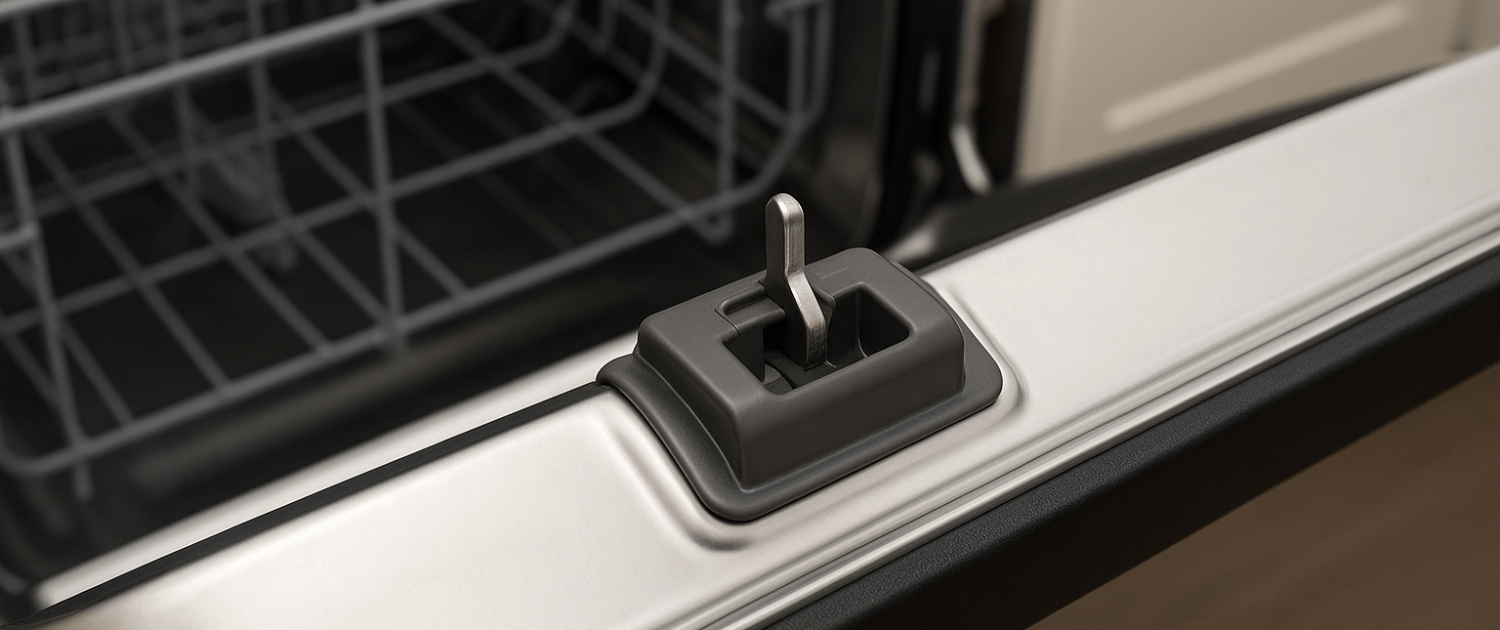

Step 3- Remove the faulty door latch
- Use the 3/16-inch nut driver to remove the screw holding the switch in place.
- Lift the switch up and off the alignment pin, taking care to thread the attached wires through the plastic holdings so they don’t get damaged.
- Using a flathead screwdriver, gently pry up on the plastic locking tabs on either side of the door latch housing to release the assembly.
- With the tabs loosened, pull firmly to slide the entire door latch mechanism forward and detach it from the dishwasher frame.
Step 4- Install the new door latch
- Slide the replacement door latch into position on the inner door frame, pressing firmly to lock the plastic tabs back into place with an audible click.
- Thread the door switch wires back through their plastic holders and mount the assembly onto the alignment pin.
- Insert the retaining screw through the bushing on the switch mechanism and tighten it down with the 3/16-inch nut driver until snug.
