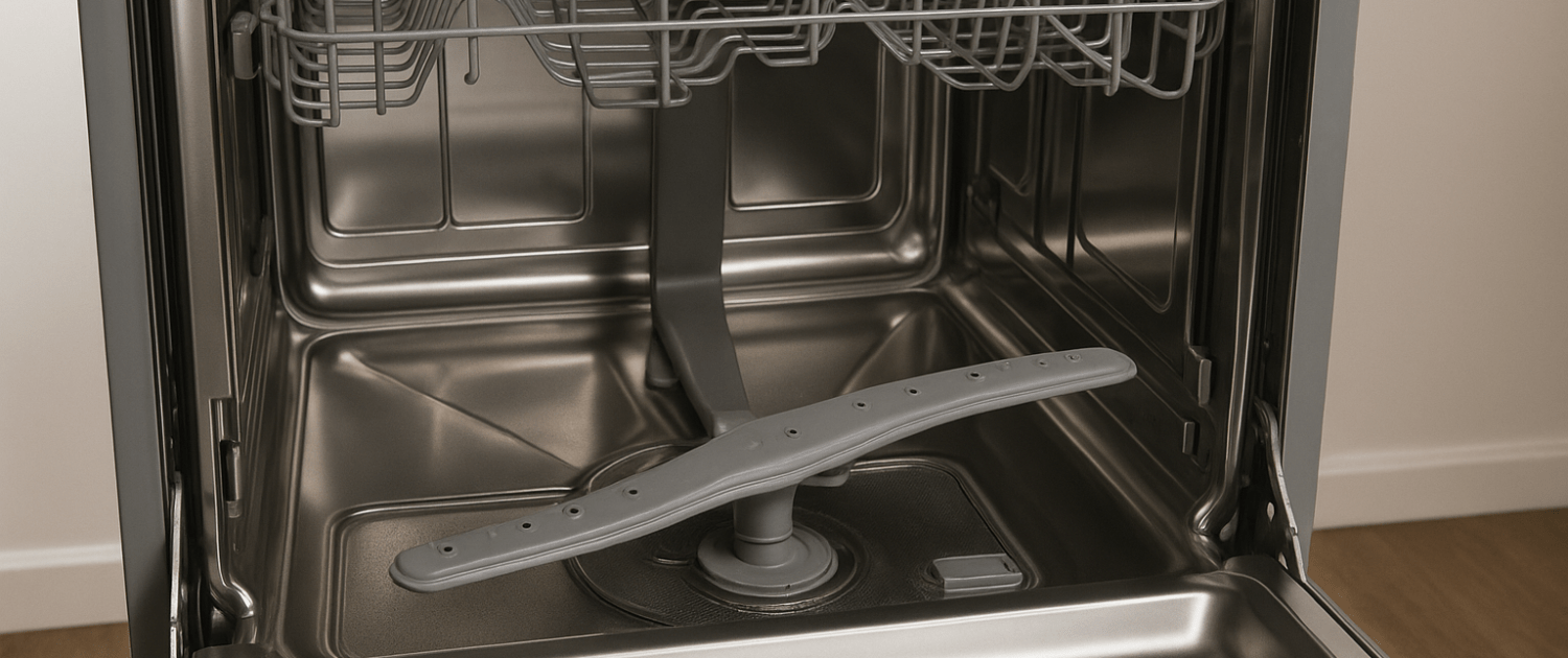

Step 1: Access the lower spray arm
- Open the dishwasher door and locate the lower dish rack.
- Carefully roll out the lower dish rack and lift it up, placing it on a counter or sturdy surface nearby.
Step 2: Remove the old lower spray arm
- Locate the plastic base that holds the lower spray arm in place. This plastic base is at the center of the dishwasher cavity, where the water supply tube is located.
- Twist the plastic base counterclockwise to unlock the spray arm from its position. You may need to apply some force to overcome any resistance but be careful not to use excessive force to avoid damaging the plastic base.
- Once the plastic base is loosened, you can remove the old lower spray arm from the water supply tube.
Step 3: Install the new lower spray arm
- Inspect the new lower spray arm and identify the locking tabs and pins on its base. Typically, there are four locking tabs and four corresponding pins that help secure the spray arm in place.
- Carefully place the new spray arm onto the water supply tube, aligning the pins on the spray arm with the spaces between the locking tabs on the plastic base.
- Once the pins are positioned correctly, turn the plastic base clockwise until you hear a distinct click. This clicking sound indicates that the spray arm is securely locked into place.
It’s important to make sure that the new lower spray arm is properly installed and securely locked in position to prevent any water leaks or improper rotation during the wash cycle.
Step 4: Finish up
- Carefully place the lower dish rack back onto the wheels or guides inside the dishwasher cavity, and slide it back into its original position.
- Close the dishwasher door, making sure that it is properly aligned and secured.
- Plug the dishwasher back in or turn the circuit breakers back on to restore power to the appliance.
- Run a test cycle with the dishwasher empty to make sure that the new lower spray arm is functioning correctly. During the cycle, observe the water distribution and rotation of the spray arm to verify that it is operating as expected.
