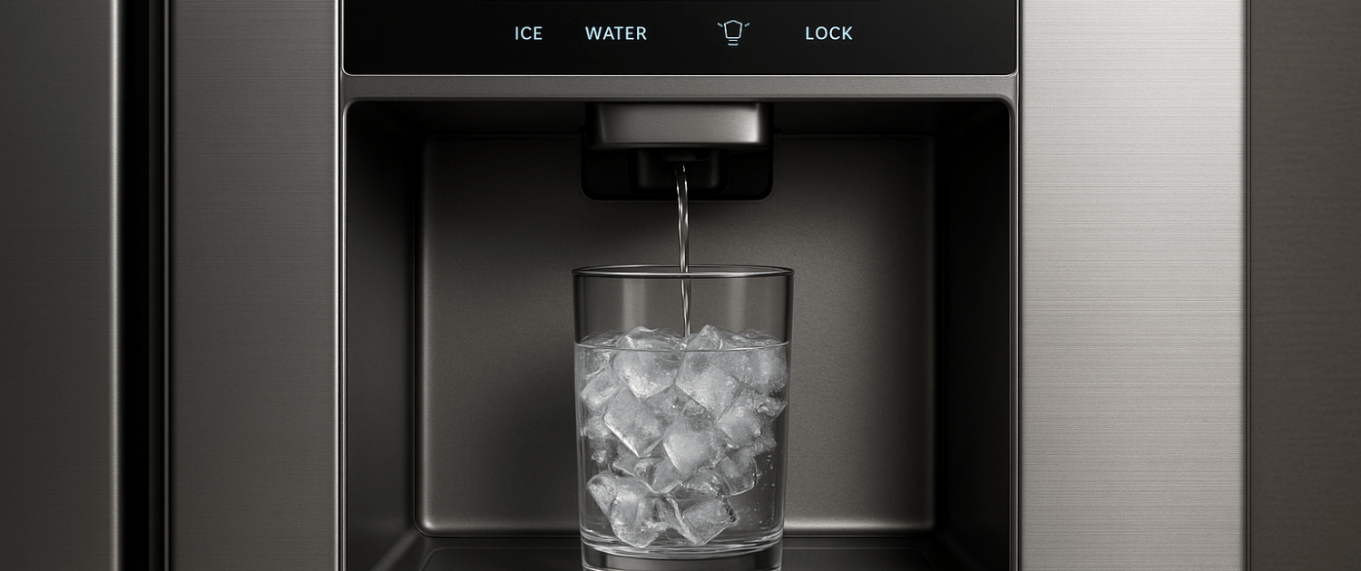

Is your fridge’s water dispenser suddenly refusing to cooperate? Don’t worry; it’s a common issue often traced back to a simple problem—an ineffective water dispenser lever. With our step-by-step guide and a handy how-to video just below, you’ll have your appliance dispensing cool, refreshing water again in no time!
Looking for the right part? Enter your appliance model number below to find the exact match and get your appliance running like new again!
If the water dispenser on your Whirlpool, KitchenAid, or Maytag refrigerator has stopped working, the issue likely lies with the water dispenser lever. This small plastic part activates the switch to release water when pressed. Over time, this piece can crack or break entirely, preventing water flow. Replacing this affordable part is an easy DIY fix that will have your water dispenser working again in no time.
