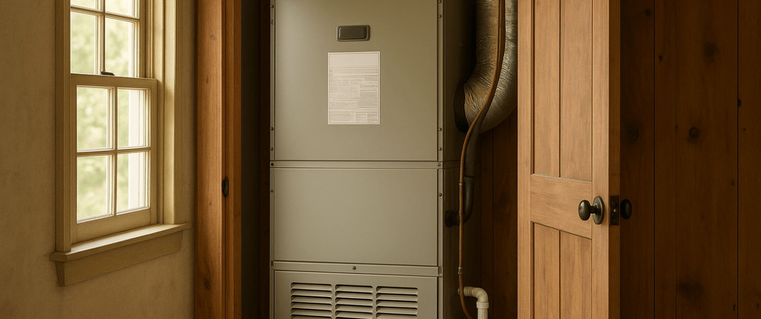

How to Retrofit Central AC Into an Older Home Without Ducts
Steven E / Wednesday June 25, 2025
Living in an older home has its perks, charming architecture, solid craftsmanship, and plenty of character. But it often lacks one key modern convenience: central air conditioning. If you’re sweating through the summer and dreaming of cool, consistent indoor temperatures, you’ve probably asked yourself the question: Can I retrofit central AC into my older home without any existing ductwork?
The short answer: Yes, you can. The better news? You can do much of the planning, prep, and even parts of the install yourself, no need to rip open walls or gut your historic beauty. With the right approach, retrofitting AC into a ductless home is not only possible, it can be surprisingly smooth.
This guide walks you through the process, options, tools, and steps to take if you want to take on this home upgrade.
