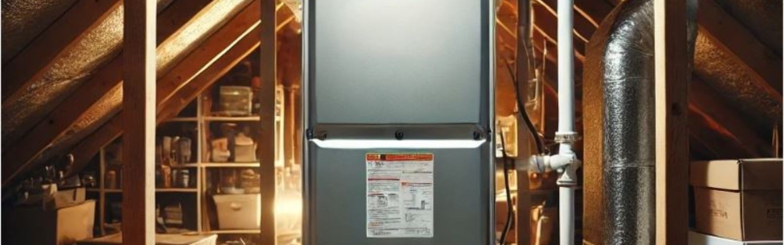

How to test and replace the blower motor on an electric furnace
Steven E / Wednesday January 22, 2025
Having trouble with your electric furnace not pushing warm air like it used to? The blower motor might be acting up. But no worries. You can test it and replace it yourself with a bit of guidance. Let’s walk through the steps to get your furnace back in action.
