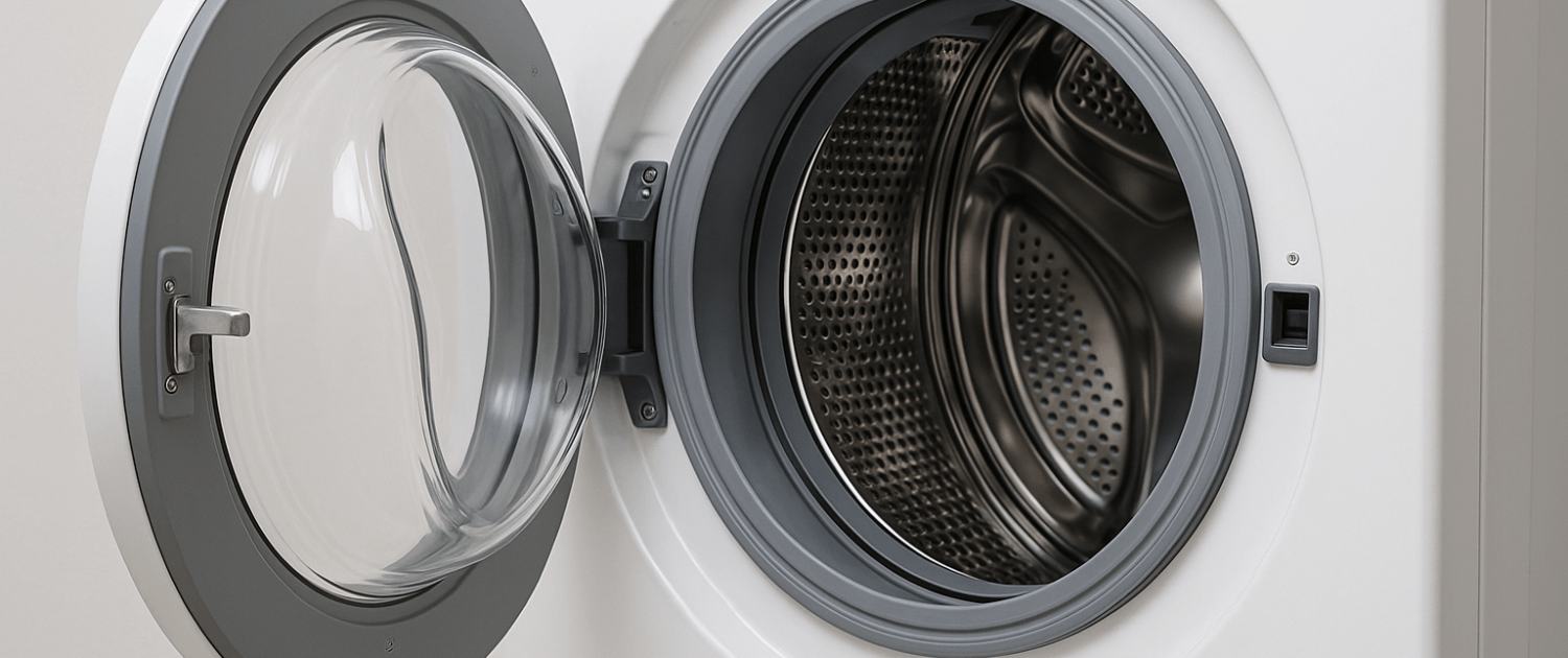

How to test and replace the LG washer’s door boot seal
Here are the steps to remove the old door boot seal, install a new one, and reassemble your LG washer for proper operation.
