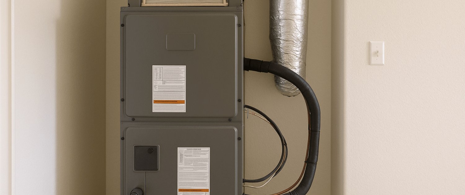

Step 7: Check the Blower Motor (Indoor Unit)
Your indoor blower motor pushes air through the ductwork. If it’s dirty, overloaded, or has a failing capacitor, it can trip the breaker when it tries to start.
What to do:
- Turn off power to the furnace or air handler.
- Remove the panel to access the blower compartment.
- Clean off any visible dust or debris from the fan blades.
- Check for signs of overheating or wear on the motor.
- Spin the fan wheel by hand, it should move freely without grinding.
If the motor is hot to the touch or smells burnt, it may need to be replaced.
