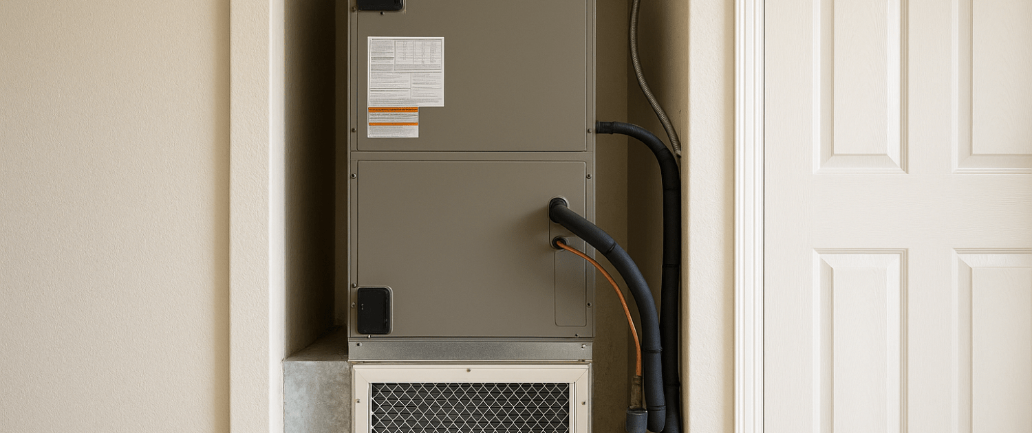

Tighten or Replace the Blower Motor Assembly
Whirring, squealing, or vibrating sounds often come from a loose or dirty blower wheel in the indoor unit.
- Shut off power and remove the access panel on your air handler or furnace.
- Locate the blower wheel and motor assembly, usually behind a metal panel secured with screws.
- Visually inspect the blower wheel, is it clogged with dust or debris? Does it wobble when spun?
- Vacuum dust and debris carefully from the wheel and housing.
- Check and tighten the set screw on the blower wheel that holds it to the motor shaft.
- If the wheel is cracked or unbalanced, replace it with a matching part.
- Reassemble everything, ensuring all panels are snug.
Pro Tip: If your unit has a belt-driven blower, inspect the belt for cracks or looseness. Adjust tension or replace if necessary.
