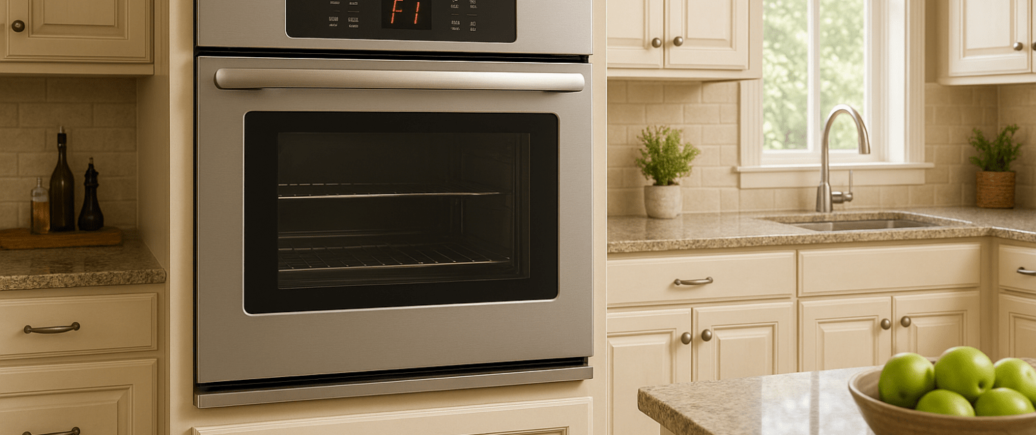

What is the F1 error code?
The F1 fault code signifies that the meat probe ,also known as a temperature sensor, has failed during a test or service mode cycle on the oven. This could indicate a problem with the probe itself, or an issue with the connections between the probe and the oven. On Bosch ovens, the F1 code is only displayed during a test or service mode – you wouldn’t see it during normal cooking operations.
