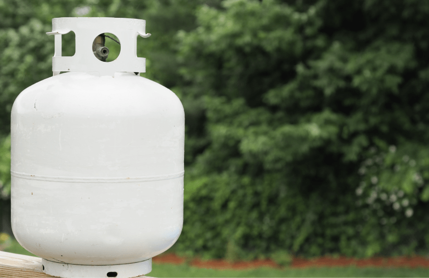

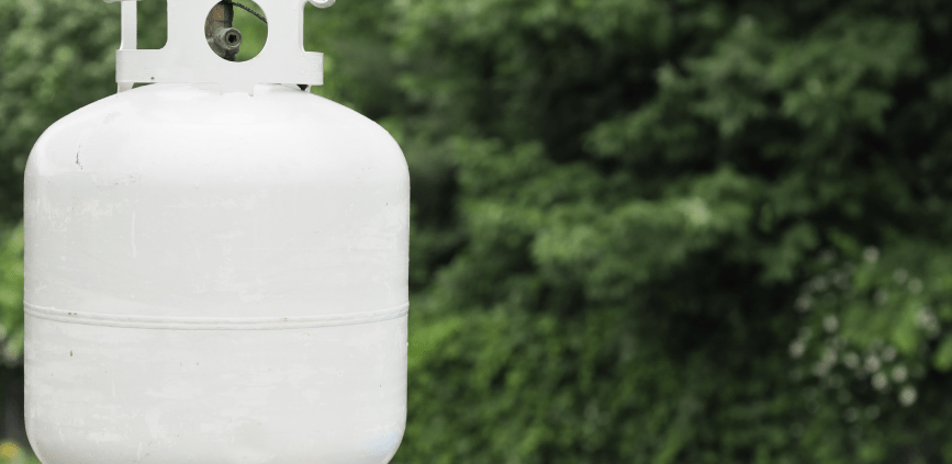

The Basics: Proper Propane Tank Storage & Care
Propane tanks are durable and safe to use, but that doesn’t mean you can skimp on safety measures when it comes to storage and use. Even if your tank is empty, you should still follow these basic propane tank storage safety tips:
- Before putting your propane tank away, make sure the valve is in the OFF position. Inspect valves and indicators before each use, as well.
- Propane tanks should be stored in an upright position, never upside down or on their sides.
- Store your propane tank in a shaded, well-ventilated area. It doesn’t necessarily need to be protected from the elements – although this can help stave off corrosion – but it does need to be kept out of direct sunlight. An ideal spot for propane tank storage is in a shed not attached to your home.
- Propane tanks should not be exposed to temperatures higher than 120 °F (49 °C) or lower than -40 °F (-40 °C).
- Don’t store your propane tank in your home. Except in instances of extreme weather, it’s perfectly safe to store your propane tank outside.
- Avoid storing your propane tank in your vehicle for extended periods, particularly during summer. Vehicle temperatures can rise significantly higher than the ambient air temperature, posing potential risks.
- If you are using a propane tank for a boat, camper, or other mobile living space, it is crucial to have carbon monoxide detectors installed. Additionally, make sure to test them regularly to ensure they are in good working order.
