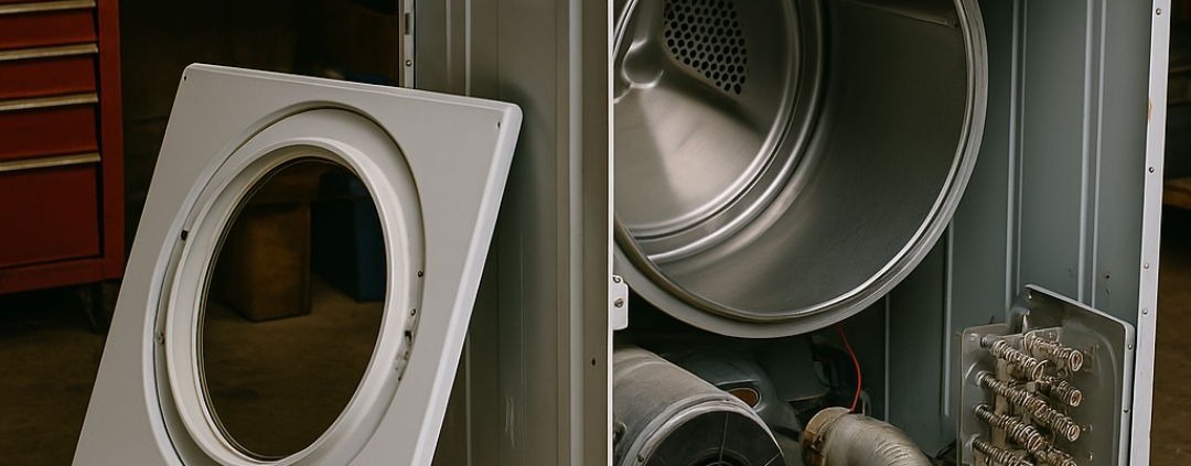

Accessing the back of the dryer
- Start by unplugging the dryer from the electrical outlet for safety.
- The idler pulley is located in the back of the machine, so we need to remove the rear access panel.
- Use a nut driver to remove the screws securing the panel.
- Take off the panel and set it aside.
Removing the belt and idler arm
With the panel removed, you now have access to the belt and idler arm assembly.
- First, release the tension on the belt. Reach into the dryer and push the idler pulley bracket towards the side of the machine. This will loosen the belt enough to unhook it from the motor pulley.
- Slide the belt off and set it aside.
- Next, use a 5/16-inch nut driver to remove the lower screw from the idler arm. This releases a spacer and allows you to detach the idler arm.
- Reach into the dryer and unhook the spring from the bottom of the idler arm, then slide the entire assembly out.
