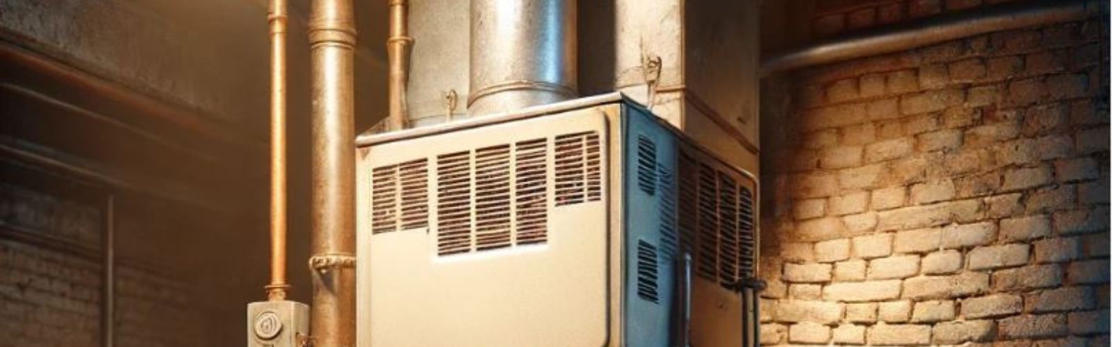

Top causes of a furnace blower that won’t turn off
Steven E / Tuesday March 18, 2025
Is your furnace blower refusing to shut off? A blower that runs non-stop isn’t just a nuisance, it can also spike your energy bills. But don’t worry; we’re here to help you figure out what’s going on and how you can tackle it yourself like a Pro.
