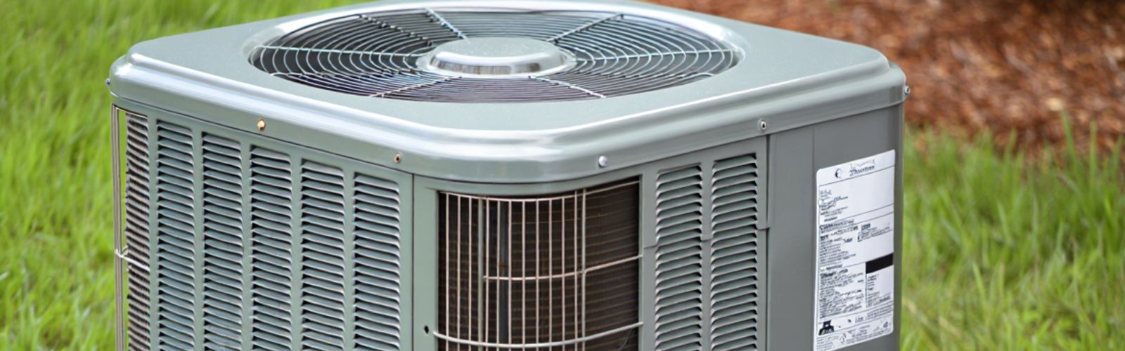

Condenser air flow blocked
- Inspect the outdoor condenser unit for any obstructions, such as debris, vegetation, or objects blocking the airflow.
- Clear away any obstructions, ensuring a minimum of 2 feet of clearance around the unit.
- Clean the condenser coils using a coil cleaner and a soft brush, being careful not to bend the delicate fins.
- Check that the condenser fan is running properly and drawing air through the coils.
