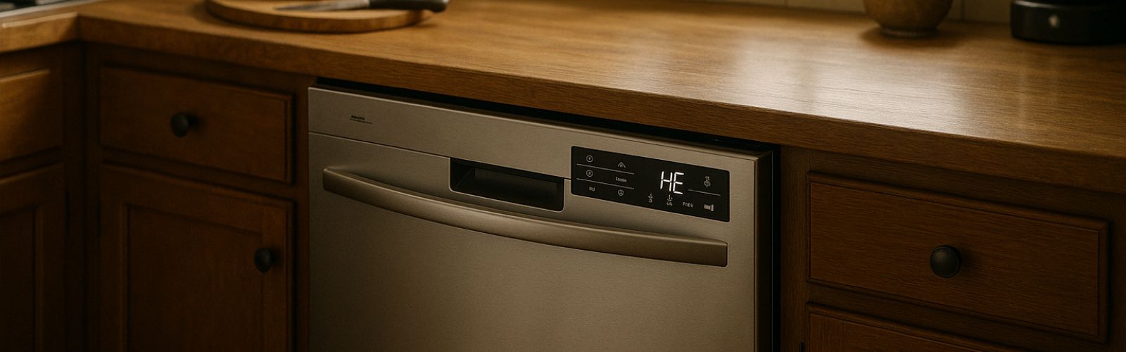

Is your LG dishwasher displaying the error code HE? Don’t worry, this is a problem that you can fix yourself without the need for a costly service call and we’re here to help you do it, like a Pro!

The error code “HE” on an LG dishwasher typically indicates an issue with the heating element or the control board. If the water in the dishwasher tub is not heating up as expected, the HE error code may be displayed. This could be due to a problem with the heating element, such as a short circuit or a break in the heating element circuit.
