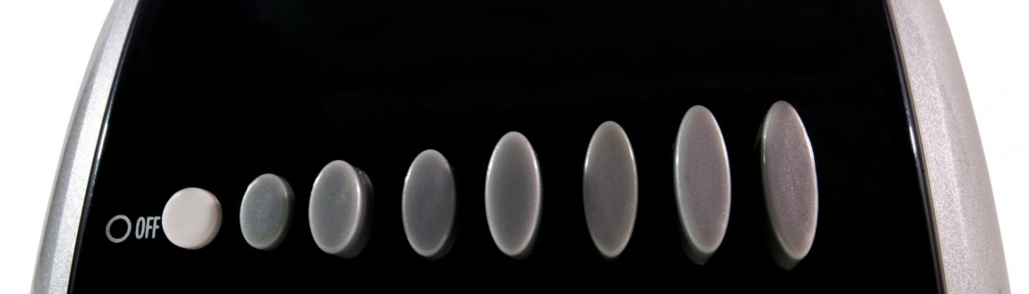

When blender buttons refuse to budge, your first step is some detective work to determine the cause. Before working on any appliance, make sure it’s turned off and disconnected from the power source.
After months or years of blending a variety of ingredients, it’s inevitable that food particles, oils, or other gunk will build up around the buttons.
How to fix:
- Disconnect the blender from its power source.
- Inspect the openings around each button for any visible debris.
- Remove the jar and place the blender base upside down.
- Grab a clean toothbrush and gently brush around the blender buttons, scrubbing out any built-up grease or crumbs.
- Use a dry cloth to wipe away any residue loosened by brushing.
