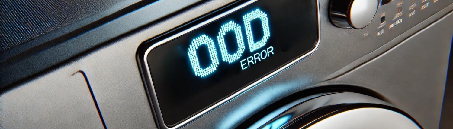

What the 00d error code means
On GE dryers, the 00d error code usually indicates that the control board is detecting the door switch signal as stuck closed after five consecutive drying cycles.
This is similar to error 008, which signifies the physical door switch is stuck. But in the case of 00d, the issue lies in the control board’s internal door switch detection circuitry – not the switch itself.
When operating correctly, the control board monitors the door switch signal at pin J1-3. It expects the signal to cycle open and close as the door is opened and shut. But if the board incorrectly reads this signal as stuck closed over 5 cycles, it will log error code 00d.
So while the door switch may be working fine mechanically, the error stems from a fault in the control board’s sensing circuit.
