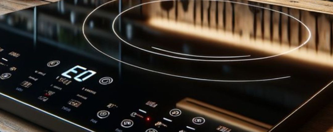

Even the most advanced appliances can encounter occasional problems, and one such challenge that GE induction cooktop users may encounter is Error Eo.
Thankfully, you can usually troubleshoot this issue yourself without the need for an expensive service call or technician.
If you find out that you need any replacement parts for your GE cooktop while you’re troubleshooting, you can enter your model number at AppliancePartsPros.com to order them. Most orders arrive in just two business days, and we have thousands of free guides to show you how to install your new parts.
Important: The error code information in this article is based on general service manuals and may not apply to your specific appliance model. While we strive to offer helpful advice for DIY appliance repairs, variations in models and configurations can lead to differences in troubleshooting steps, error codes and part replacements. For the most accurate guidance, we strongly recommend consulting the technical sheet for your specific appliance model.
What causes the Eo error?
The Eo error code typically indicates that the rate of temperature increase is too fast or the temperature at the element is too high for the cooktop. This may be caused by the following:
- Heating empty or incompatible cookware: Induction cooktops require compatible cookware with magnetic properties to transfer heat. If you place an empty or non-compatible pan on the cooktop and select a high power level, the induction element may overheat.
- Obstructions in the fan or vent: Blockages in the cooktop’s cooling fan or vents to the control board can disrupt the cooling process.
- Damaged or faulty heating element: A faulty element may not regulate temperature correctly, which could lead to rapid temperature increases that trigger the Eo error.
Pro tip: You can recall stored error codes on your cooktop by pressing the Timer on/off and Control Lock buttons at the same time for 10 seconds. Error codes will appear in the display window for the element that has a problem.
