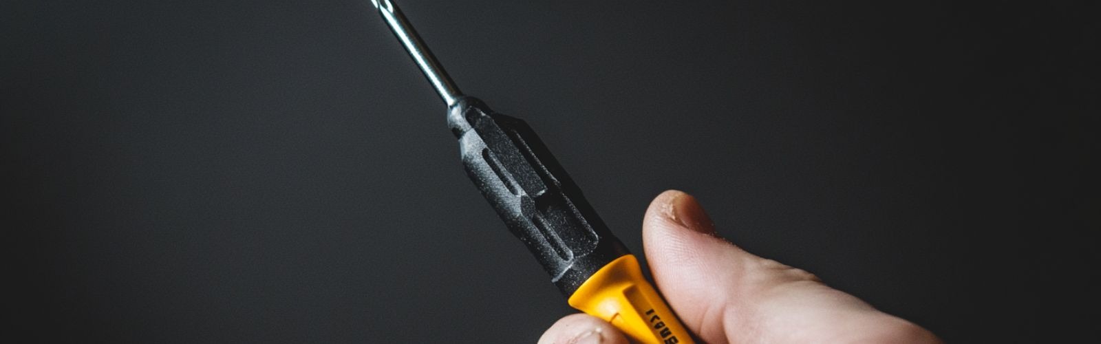

Essential tools for testing appliance parts
Having the right tools makes the job easier and safer. Here’s what you’ll need:
- Multimeter: For measuring electrical values. Learn more in our guide on how to use a multimeter to check appliance parts.
- Screwdrivers: Both flathead and Phillips for opening panels.
- Needle-nose pliers: For gripping small parts.
- Safety gear: Gloves and safety glasses to protect yourself.
