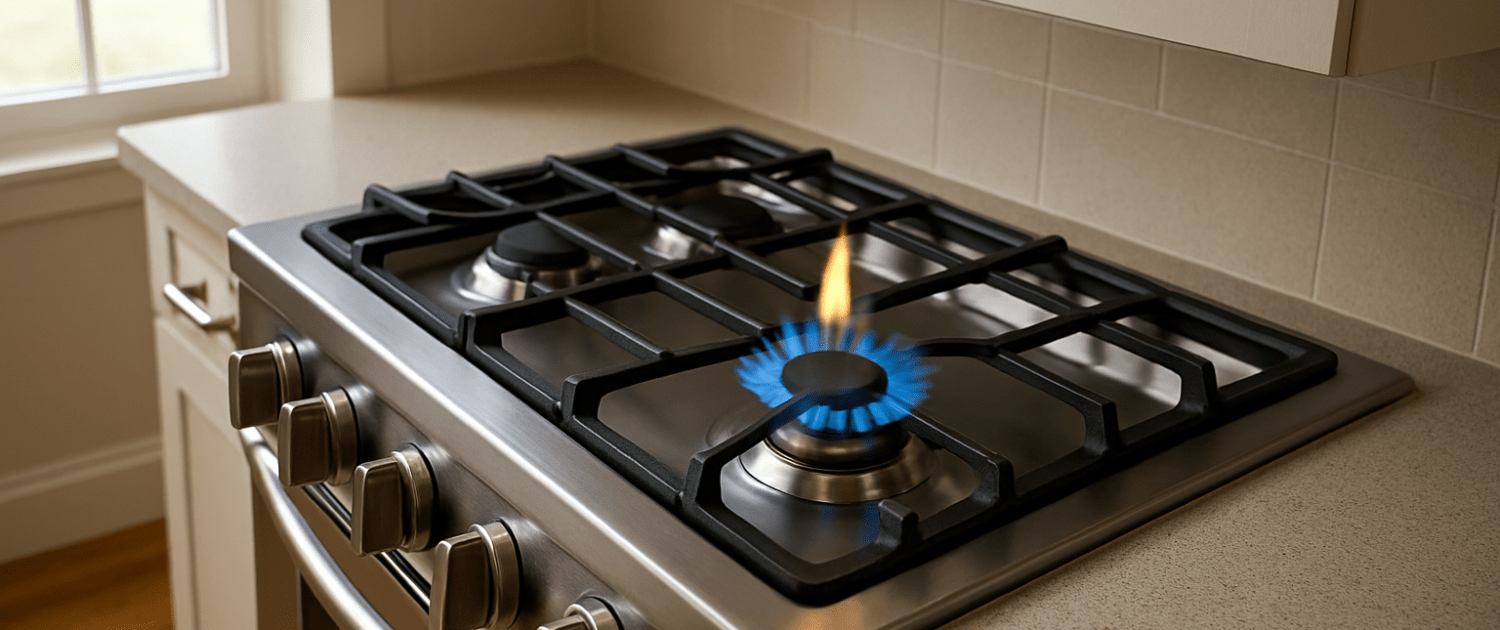

Why Your Burner Flame Should Be Blue
A properly functioning gas burner produces a clean, stable, blue flame. That blue color tells you that the gas is mixing with the right amount of air and burning efficiently.

A yellow or orange flame, on the other hand, is a sign that something’s wrong.
What Causes a Yellow Burner Flame?
When your cooktop flame burns yellow, it means the gas is not mixing with enough oxygen before it burns. This is called incomplete combustion. Instead of burning cleanly, the gas produces more soot, carbon monoxide, and less heat.
