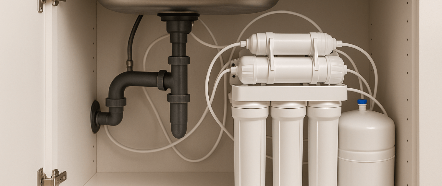

Check the Fittings and Push-In Connectors
RO systems use quick-connect (push-to-fit) fittings, which are super convenient but can loosen over time or if bumped.
What to do:
- Push the tubing in firmly to make sure it’s seated all the way.
- Then pull gently, if it comes out easily, the connection wasn’t secure.
- If the leak continues, turn off the water, remove the tubing, and check for scratches or cracks on the tubing, dirt or debris inside the fitting, and a worn-out O-ring or collet.
How to fix:
- Cut a fresh, clean end on the tubing using a sharp utility knife.
- Reinsert it fully into the fitting.
- If the fitting itself is cracked or worn, replace it, it’s a cheap and easy fix.
Inspect the Filter Housings
If the leak is coming from around one of the filter canisters, you’re likely dealing with a loose housing or a bad O-ring.
How to check:
- Wipe the housing dry and look for leaks around the top or bottom of the canister.
- Use the RO wrench (that came with your system) to gently tighten the housing clockwise.
Caution: Don’t overtighten, it can damage the threads or crack the plastic.
If the leak persists:
- Turn off the water and unscrew the housing.
- Remove the filter and check the O-ring.
- Is it dry, cracked, or misaligned? Lubricate it with food-grade silicone grease and reseat it properly.
- Replace the O-ring if it’s worn out.
Screw the housing back on, turn the water back on, and check again for leaks.
Look at the RO Faucet
Leaks from the RO faucet are usually pretty easy to spot, they’ll often drip down onto your sink or counter.
- Loose fittings underneath the sink
- Cracked base or faucet body
- Leaky air gap
If your system uses an air gap faucet (a small hole or bump in the faucet stem), water leaking from the hole means there’s a clog in the drain line.
What to do:
- Remove the drain tubing and clean it out with a pipe cleaner or brush.
- Clear any debris that might be backing up water into the air gap.
For leaks at the base of the faucet, tighten the mounting hardware or replace washers and fittings as needed.
Check the Storage Tank
The pressurized storage tank can sometimes develop leaks at the top valve or around the base.
What to look for:
- Water pooling around the bottom of the tank
- Drips coming from the valve or tee fitting at the top
Fixes:
- Tighten the top valve or fitting using a wrench (but not too hard).
- If the tank itself is leaking (from a seam or weld), it will need to be replaced.
Tanks can last 5–10 years, but eventually they wear out. If your tank is older and leaking, a replacement is usually the best solution.
Investigate the Drain Saddle
The drain saddle valve is the little clamp that attaches your RO system’s drain line to your sink’s drainpipe.
If it’s leaking:
- It may not be aligned properly with the drilled hole.
- The clamp could be loose or corroded.
- There might be gunk clogging the drain line, causing water to back up.
What to do:
- Remove the saddle clamp and clean both the drainpipe and clamp area.
- Realign it properly over the hole.
- Tighten the screws evenly on both sides.
- Make sure the drain tubing is fully inserted and secured.
If the clamp or tubing is damaged, replace it, it’s a cheap part and easy to install.
Examine the RO Membrane Housing
The membrane housing is a horizontal cylinder, usually mounted near the top of your system.
Leaks from this housing can come from:
- Loose end caps
- Worn O-rings
- Cracks in the housing itself
Fixes:
- Unscrew the end cap using your hand or a wrench (lefty-loosey!).
- Inspect and lubricate or replace the O-rings.
- Look for cracks in the plastic.
- Replace the housing if needed, it’s inexpensive and available online.
Replace Old or Brittle Tubing
If your system is a few years old, some of the plastic tubing may be getting stiff, cracked, or brittle. Tiny pinholes or hairline cracks can cause small, slow leaks that are hard to spot.
How to fix:
- Cut off the damaged section.
- Reconnect with a push fitting or install a new length of tubing.
- Use 1/4-inch or 3/8-inch food-grade tubing, depending on your system size.
Always cut the tubing square and clean to avoid leaks at the fittings.
