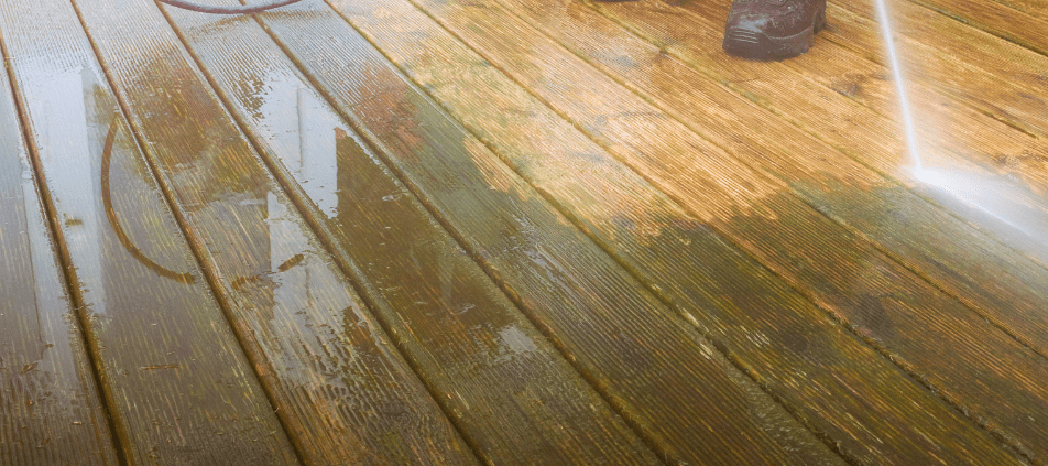

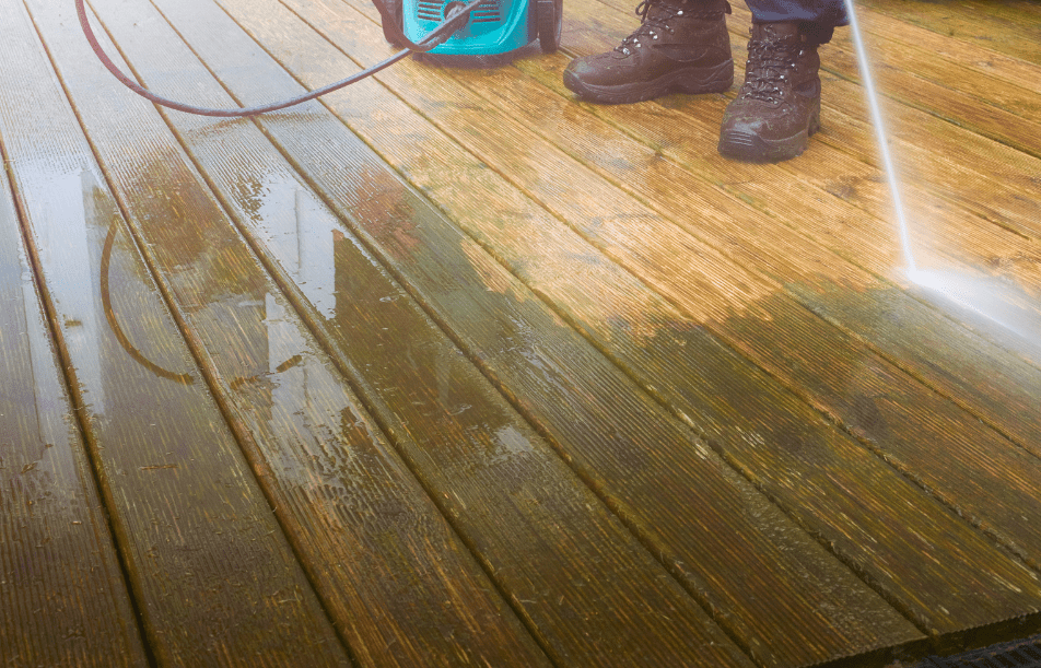

How To Clean Your Wooden Deck or Fence with a Power Washer
Thankfully, cleaning your deck or fence with a power washer is incredibly easy. Just be sure you’re following proper safety precautions. For a full safety guide for pressure washer use, check out the one on our blog. We’ll go over the basics here.
- If you’re cleaning your deck, start by moving any loose items like decorations, planters, or furniture out of the way. The pressure from the washer can potentially damage those items or send them flying. You’ll also want to cover or move any electrical components or light fixtures and make sure any young children or pets are inside or well out of the way.
- Wear appropriate safety gear when using a power washer. That includes sturdy shoes, long pants and sleeves, gloves, potentially protective eyewear, and a mask.
- Do some pre-cleaning by applying a cleaning solution (dish soap and water or oxygen bleach powder and water are fine here!) to your deck with a deck brush, then rinse it off with your garden hose.
- Time to pressure wash! You should be familiar with the basics of how to use your pressure washer before you begin – read the instructions in the user manual before you begin if you aren’t.
- Stand around 2ft from the surface you’ll be washing (no less) and with a wide nozzle and a low pressure, test an inconspicuous spot first. You want to make sure you aren’t damaging the wood with your settings.
- Once you know you aren’t going to be causing any unwanted damage to your wood, you can begin working by spraying back and forth in even strokes. Don’t let the pressure washer stay too long in one spot – it can damage the wood!
- One pass should be enough! If you’re cleaning a deck and you notice standing water, it’s not a bad idea to grab a mop or old towel to soak some of those puddles up. Otherwise, you can allow your fence or deck to dry naturally in the sun!
