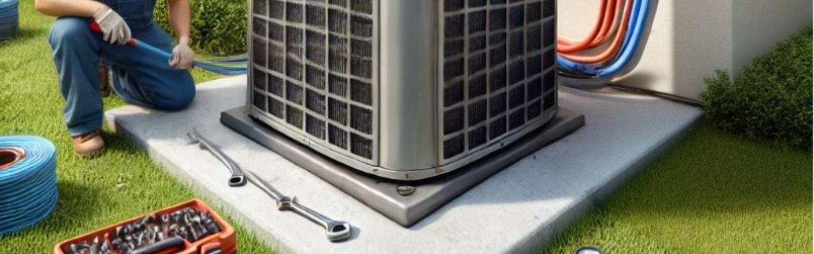

Place the outdoor condenser unit
- Choose a flat surface for the outdoor unit, like a concrete pad or solid platform. Leave enough space around it for good airflow.
- Position the condenser so it lines up well with your home’s layout for easier line set connections. Make sure it’s level.
- Secure the unit with mounting brackets or anchor bolts, following the manufacturer’s recommendations.
- Clear the area around the unit of any plants or debris that could block airflow.
