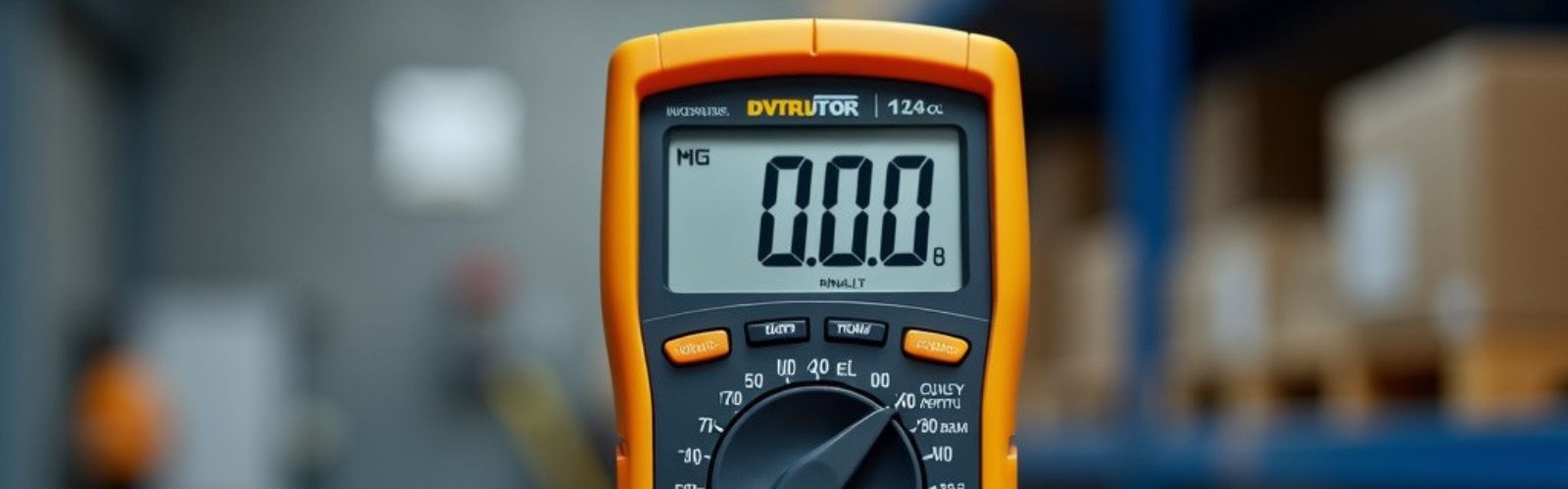

Using a multimeter: getting started
There are two main types of multimeters. For appliance repair, a digital multimeter is recommended because it provides quick, clear readings. Analog multimeters with a needle gauge can work well but can be harder to read for precise voltage measurements.
Most multimeters have separate settings for AC and DC voltage:
  • AC voltage (V~ or VAC) – used for checking power outlets, power cords, and appliance motors.
  • DC voltage (V⎓ or VDC) – used for testing control boards, touch panels, and battery-powered parts.
  • Continuity mode (Ω) – used to check if a circuit is complete, often for testing fuses and heating elements.
