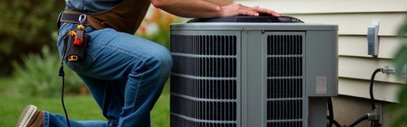

Check out the outdoor unit
- Clear away any plants, leaves, or debris crowding your outdoor condenser. Good airflow around the condenser is key for efficient heat expulsion.
- Give the fins and coils a once-over for dirt buildup. If they’re dirty, gently rinse them off with a garden hose.
- If the fins are bent, you can straighten them out with a fin comb to improve airflow.
