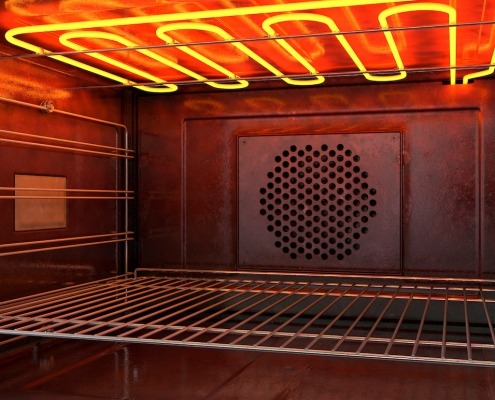

2. The Broil Element
While the broiler’s heating element should last the lifetime of your appliance, it’s possible that the element can burn or short out, leaving it too damaged to function, so we’ll check that next. In an electric oven, the broiler is powered by a calrod heating element that is generally installed on the ceiling of the oven compartment and is held in place by a few screws.
You’ll need your multimeter to completely test the broil element, but start off with a visual inspection.
  1. Run your hand over the broil element. Look for holes, cracks, swelling, or burn marks. If you see anything like this, you should replace the component.
  2. Remove the mounting screws that hold the element in place. There are usually two along the back wall and one or two on the ceiling of the oven.
  3. Pull the bake element forward, taking care not to lose the wires as you disconnect them. Use a couple of clothespins to secure the wires and keep them from falling back into the wall of the oven.
  4. Attach a probe to each terminal to test for continuity. If the element doesn’t have continuity, it’s bad and must be replaced.
