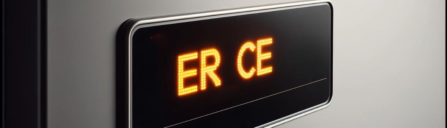

Like any appliance, refrigerators can occasionally display error codes that require troubleshooting. One common code on Frigidaire models is “Er CE”. This error usually indicates that there’s a communication issue between the refrigerator’s main control board and the user interface board.
Before you kick your fridge to the curb or call an expensive service technician, you can try troubleshooting this error yourself. If you find out that you need any replacement parts for your Frigidaire fridge while you’re troubleshooting, you can enter your model number at AppliancePartsPros.com to order them. Most orders arrive in just two business days, and we have thousands of free guides to show you how to install your new parts.
Disclaimer: The error code information provided in this article is based on general service manuals and may not apply to your specific appliance model. While we strive to offer helpful advice for DIY appliance repairs, variations in models and configurations can lead to differences in troubleshooting steps, error codes and part replacements. For the most accurate guidance, we strongly recommend consulting the technical sheet for your specific appliance model.
What causes the Er CE error?
When the Er CE code appears, it usually means the control board(s) cannot communicate properly. This can be caused by wiring issues or a failure of one of the boards.
Potential causes of the Er CE code include:
- Loose, damaged or corroded wiring between the ice maker board and the main control board located on the back of the unit.
- A malfunctioning dispenser board or main control board.
- Power surges, repeated power fluctuations or electrical problems, which can cause a temporary error to occur.
