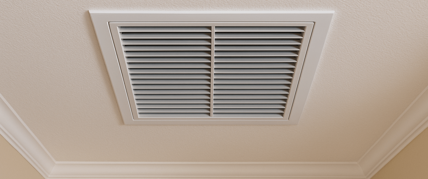

Step 2: Make Sure All Vents Are Open and Clear
Sometimes the solution is surprisingly simple: check your vents. If a supply vent is closed or blocked, the air won’t reach that room.
How to Check:
- Go room by room and inspect all supply and return vents.
- Make sure every vent is open.
- Remove furniture, rugs, or drapes that may be covering vents.
- Use a vacuum with a brush attachment to clean any dust or debris on the vent covers.
Bonus Tip: Floor vents are especially prone to being blocked by furniture or pets lying on them.
