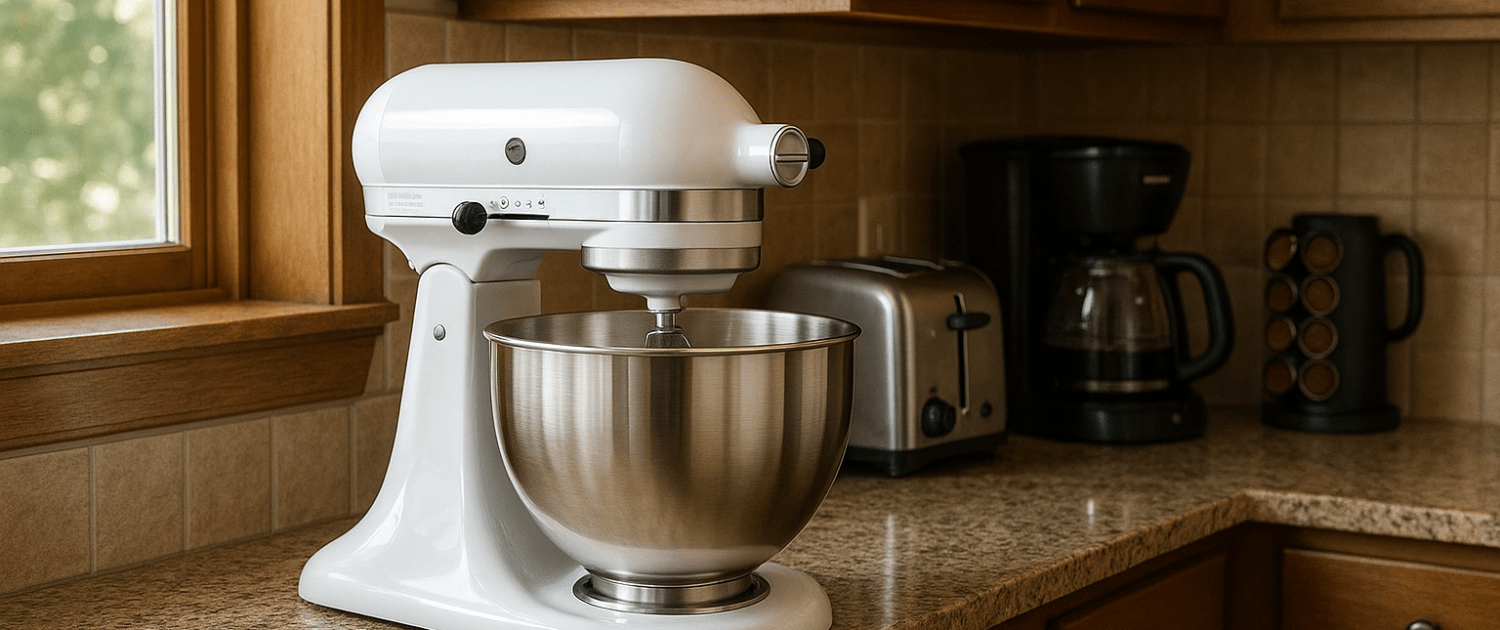

How to Adjust Bowl Height on Tilt-Head Models
On tilt-head KitchenAid stand mixers, the head tilts up and down to allow access to the bowl and attachments. The adjustment screw is located in a slightly hidden spot, but it’s easy to access once you know where to look.
- Unplug your mixer. Always make sure your appliance is unplugged before making any adjustments.
- Tilt the head back to reveal the hinge area.
- Locate the adjustment screw, it’s just behind the hinge pin, facing you when the head is tilted back.
- Turn the screw slightly using a flathead screwdriver. Turn clockwise to lower the beater (if it’s too high). Turn counterclockwise to raise the beater (if it’s scraping).
- Make small adjustments, about 1/8 turn at a time.
- Lower the head, lock it in place, and do the dime test again.
- Repeat until the dime moves slightly but doesn’t spin wildly, and the beater just clears the bowl.
Once you’ve found the right setting, plug the mixer back in and you’re good to go.
