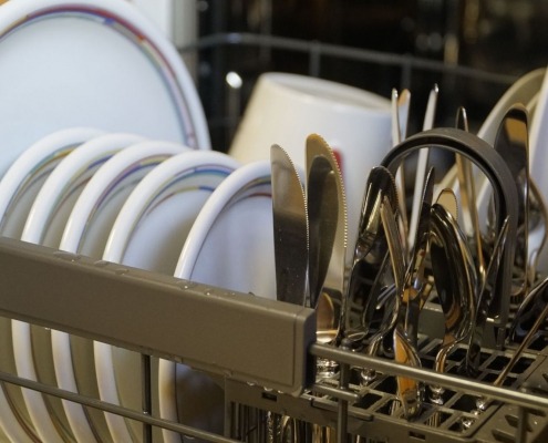

Inspect and clean the racks
Dish racks can get greasy and degraded over time with the amount of dishes they hold. Give them some TLC with these tips:
  • Remove the racks and wash them thoroughly with dish soap and water.
  • Scrub away rust spots using fine steel wool. Avoid using abrasive tools on coatings.

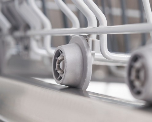

  • Check that the rack wheels roll smoothly. Replace any defective wheels.
  • Confirm the racks fit snugly without sagging. Adjust or replace loose racks.
  • Consider replacing very worn or rusted racks with fresh ones.
Read more: Painting And Repairing Rusty Or Damaged Dishwasher Racks
