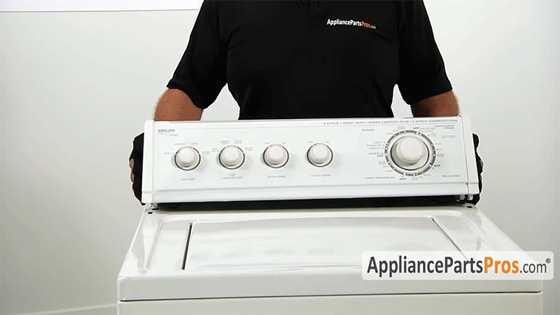

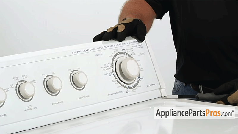

Step One: Open up the control panel
Depending on your washing machine model, there are a few different ways to disassemble the control panel:
- Is there plastic trim on either side of your washer’s control panel? You probably need to remove these covers to reach the mounting hardware holding the control panel in place. You can use a small flathead screwdriver or putty knife to pry these off.
- Most models have a pair of mounting screws on either side holding the control panel in place. These can be found either on the front or the back.
- Some models are held in place by two spring clips on either side of the control panel at the front. Slide a putty knife into the seam between the body of the washer and the control panel to dislodge the clips.
Once you’ve freed up the control panel, either by removing screws or releasing clips, grip it from the back and slide it forward. It can then be flipped over the back of the washer.

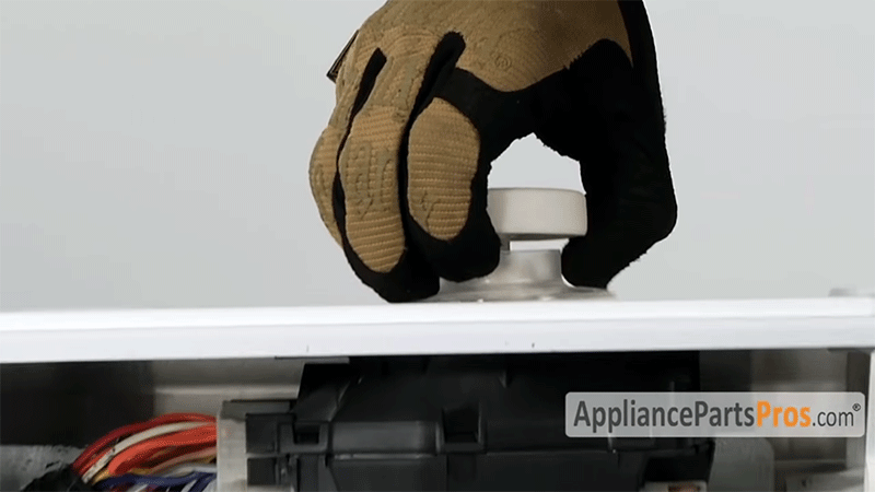

Step Two: Remove the timer knob

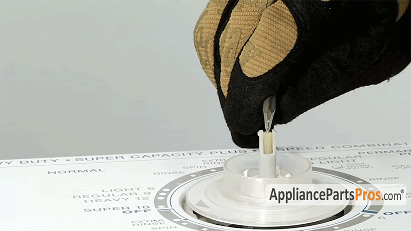

There’s a chance that your washer’s timer knob will come away by hand, but don’t force it! It may be locked in place.

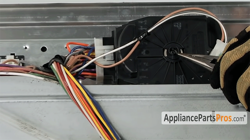

To get the timer knob off in this instance, check the back of the timer itself. There should be a shaft that turns as you turn the knob from the other side. Use your needle-nose pliers to hold this shaft in place, then tilt the control panel up and pull the timer off.

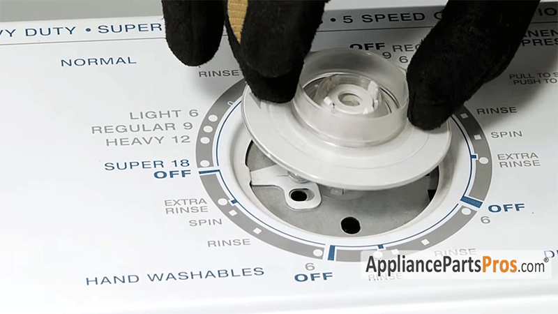

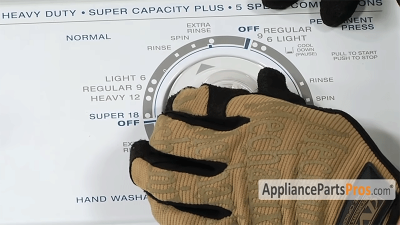

Step Three: Remove the timer dial
The dial is the flat plate behind the knob. With the knob off, you should be able to remove the dial by hand by lifting it off.
Take care when handling the knob and dial, and make sure they aren’t damaged while you work, since you’ll be reinstalling them later. If one does break, though, don’t fret! You can pick up a replacement at AppliancePartsPros.com.

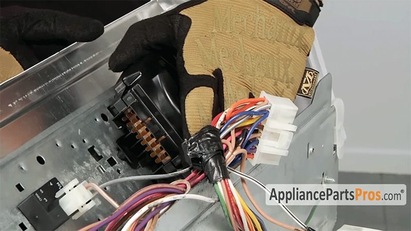

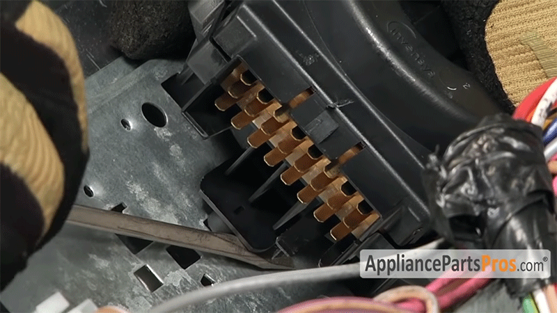

Step Four: Disconnect and remove the timer

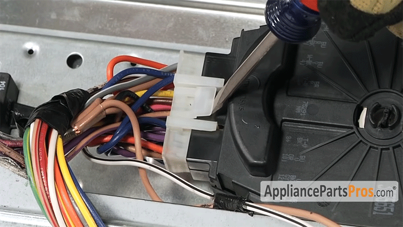

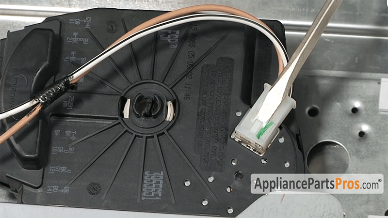

It’s time to remove the old timer! Before you can take it out, you’ll need to disconnect the wire harnesses. There are two.
The smaller harness on the back of the timer connects it to the drive motor. To remove this, use a small flathead screwdriver to release the locking tab that holds the harness in place. Once the locking tab is released, you can remove the harness by hand.
The larger harness on the side can also be removed with the help of a flathead screwdriver. Stick the screwdriver under the tab and lift it up to release it, then unplug the harness.
The timer is still held in place by one more locking tab, which you’ll find once the larger of the wire harnesses is removed. Use your flathead screwdriver to lift the tab, then slide the timer toward the center of the machine to dislodge it.

Step Six: Reinstall the timer dial
Flip the control panel back around to reinstall the timer dial. The dial has three locking tabs that must be properly aligned so that the dial will lock into place. Once lined up, you can push the dial into place.

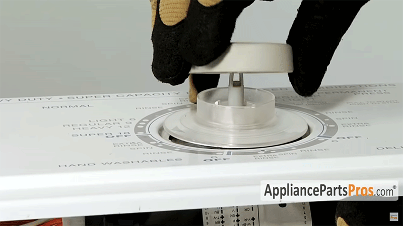

Step Seven: Reinstall the knob
You may need to adjust the timer shaft to install the knob. On our washer, the shaft needed to be pulled up, and then the inner portion pressed down with a flathead screwdriver. Check out our video for a detailed look at how this is done.
Once the shaft is properly positioned, you can reinstall the knob by pushing it into place. Check on the bottom of the knob before doing this. Two sides of the inner shaft on the knob should be flat. These need to be aligned with the tabs on the shaft to properly secure the knob.
Be sure to give the knob a turn to make sure it works properly before moving on to the next step!
