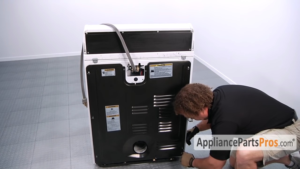

1: Remove the back panel
Matt with AppliancePartsPros replacing a whirlpool dryer heating element

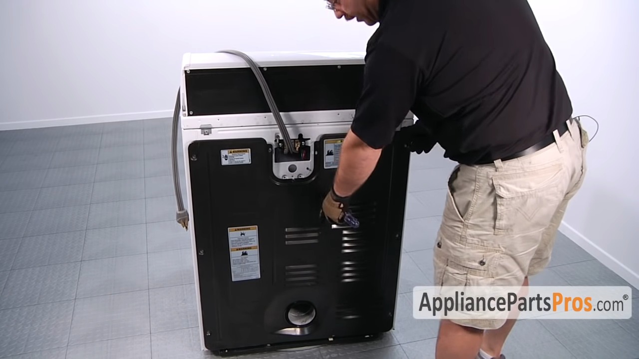

Your first step is getting the back panel off of the dryer. It should be held in place by nine or so nuts – three on each side and three at the top. Use your ¼-inch nut driver to loosen and remove them.
Once all the nuts are removed, pull the smaller panel near the top off the back of the appliance and lift the power cord up and out of the way. You can drape it over the front of your dryer. This will make it easier to lift the larger panel off. Go ahead and set it aside.

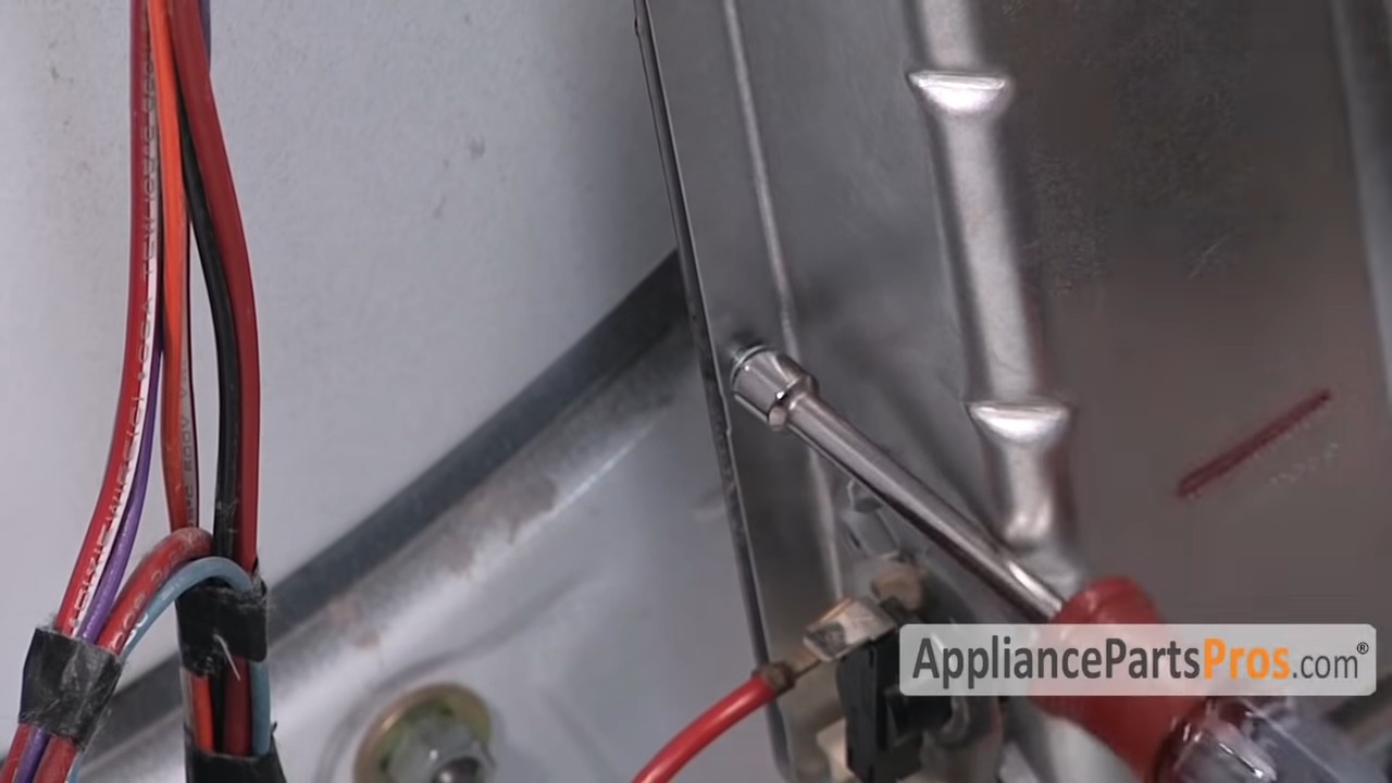

A number of wires will be attached to the heating element via the terminal block and thermostat. You’ll need to reconnect these in the same order when you install your new heating element, so make note of where each one is connected now, either by labeling them with masking tape or taking a photo with your phone.
Once you’ve labeled or taken a picture, you can start disconnecting. You may be able to do this by hand, but those connections are usually pretty snug. If that’s the case, you can use a flathead screwdriver to pry them all off.

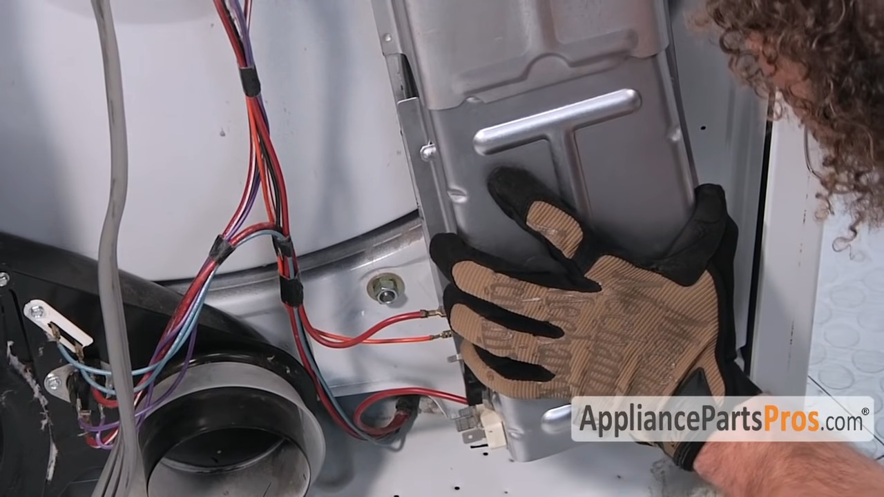

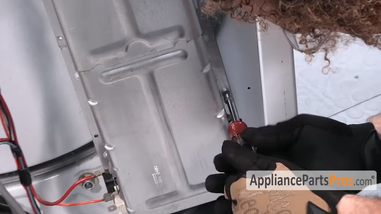

3: Remove the old heating element
The old heating element is held to the heating tube by two hex head screws or nuts. Remove those with your ¼-inch nut driver, then slide the heating element down and out of the heating tube to remove it.

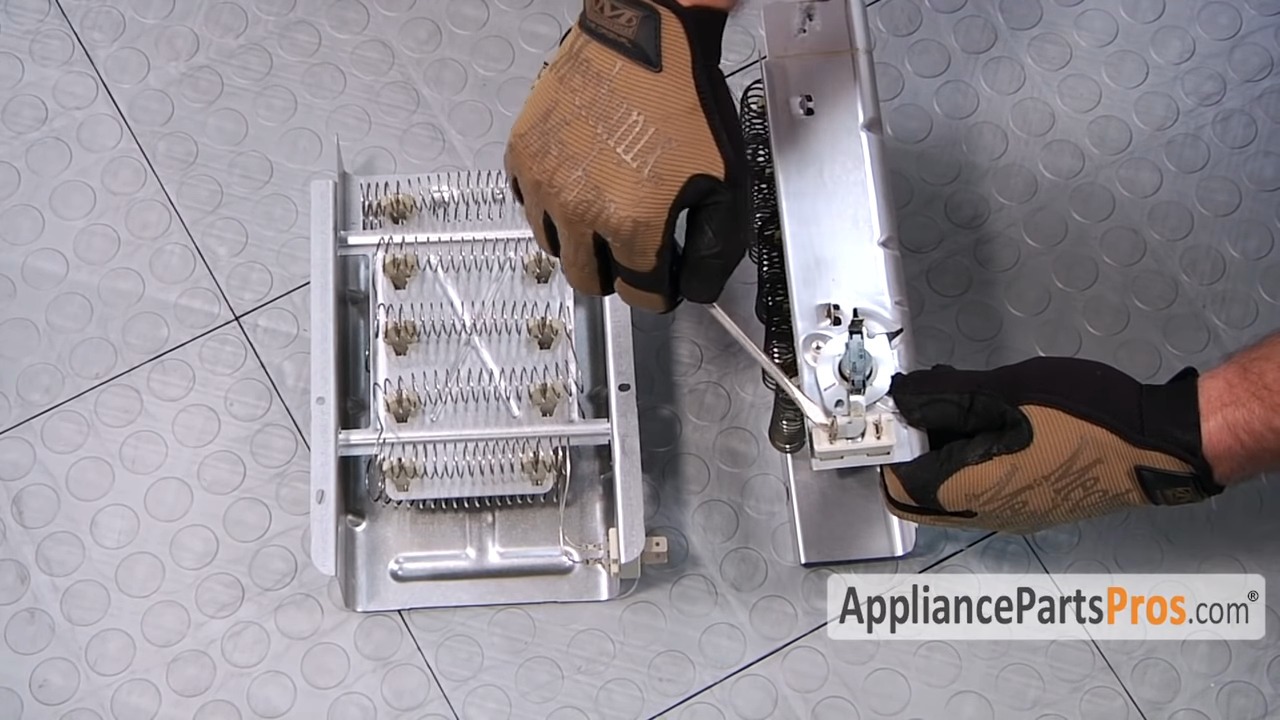

4: Install the thermostat on the new heating element

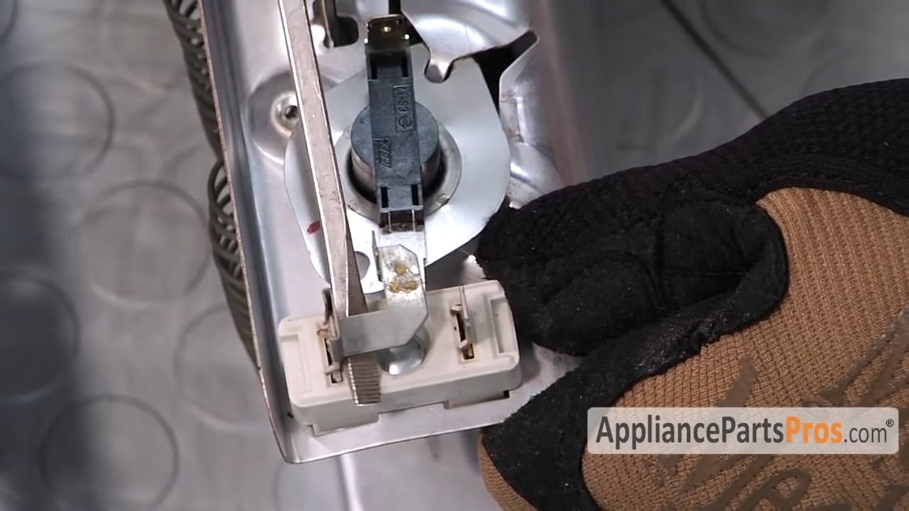

Unless you’re also replacing the heating thermostat, you’ll need to move the thermostat from the old heating element to the new one now. To do this, slide a flathead screwdriver under the terminal and pop it up and off.

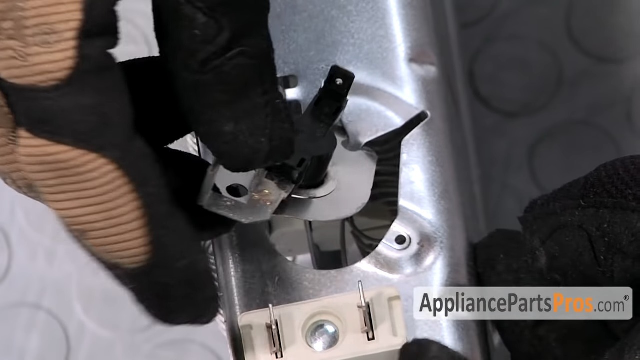

Once the thermostat is free of the terminal, simply rotate it to free it from the tab holding it in place. You can then seat the thermostat on the corresponding tab on your new component and push the connector into place on the terminal.

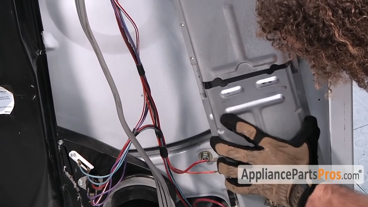

5: Mount the new heating element onto the heating tube
Line the new heating element up with the tub and press it up into place until the screw holes align. From here, you can reinstall the two hex head screws you removed from the old heating element.
