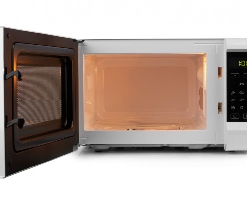

First things first, what exactly is a microwave choke cover? This is a crucial component you’ll find installed along the inside frame of the microwave door.
The cover wraps around the window preventing microwaves from leaking out through small gaps in the door. The waved metal pattern you see on some covers helps block this electromagnetic energy.
Over time, normal wear and tear can cause the thin metal cover to bend or break. If damaged, small amounts of radiation can seep out, impacting the microwave’s performance. Replacing the old cover restores safety and efficiency.

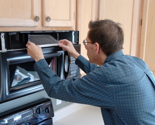

Remove the Old Cover
With your tools gathered, it’s time to take off the existing choke cover:
  1. Locate the plastic locking tabs – The cover snaps securely into place using small plastic tabs protruding through holes along the door frame.
  2. Insert a putty knife – To remove the tab from the hole, gently slide a putty knife underneath it, being careful not to apply too much force that might cause the brittle tab to break.
  3. Use a second putty knife to brace – As you release each subsequent tab, position another putty knife inside the door panel behind the cover. This braces it so the freed tabs don’t snap back into place.
  4. Work around the entire cover – Slowly make your way around the entire perimeter of the cover, releasing tab after tab. There may also be a central locking tab to detach.
  5. Remove the old cover – To free each tab, carefully and gently pull the cover away from the door. Make sure to set aside this choke cover, as it will not be needed for reuse. Take your time and make sure that all tabs are released before proceeding.
