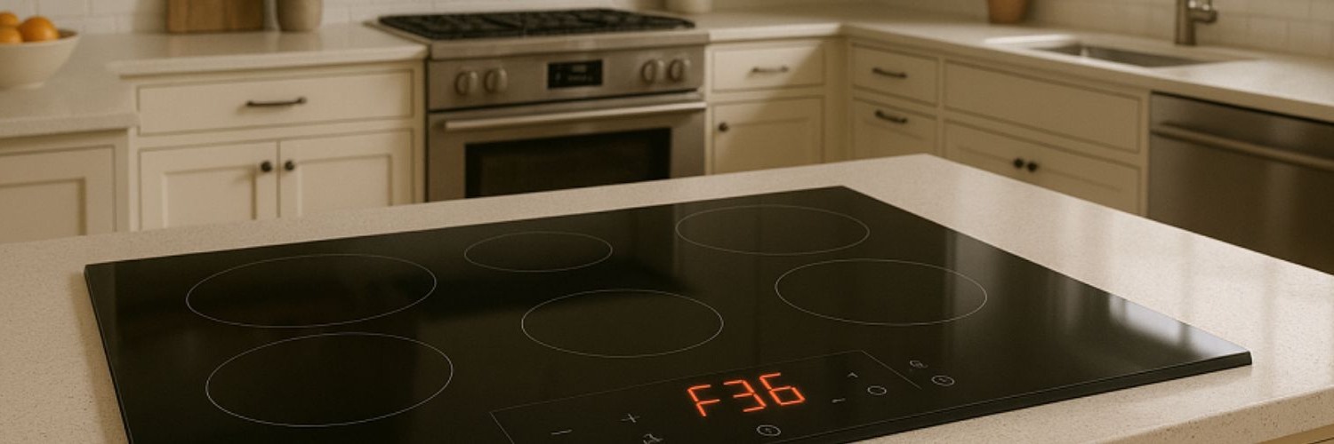

Got the F36 error code flashing on your KitchenAid ceramic cooktop with electronic touch controls? That one means there’s a temperature probe hardware error, basically, your cooktop can’t properly read surface temperature because the sensor is either faulty or can’t communicate with the control board. But don’t stress! We’ll walk you through what causes the F36 code, how to troubleshoot it, and when it might be time to replace a part.

What is the F36 error code?
F36 indicates a “temperature probe hardware error” on KitchenAid ceramic cooktop models with electronic touch controls. These error codes occur when the control board detects a problem with the temperature probe circuit. This could indicate a faulty probe, wiring issue, or problem with the control board.
These cooktops have a temperature sensor located below the glass surface. The probe monitors the temperature of the entire cooktop during operation. It provides temperature feedback to the electronic control board. Accurate temperature monitoring is important for regulating the glass surface temperature and activating the hot surface indicator lights.
On a KitchenAid electronic ceramic cooktop, fault codes are displayed through a combination of LED lights on the two front burners.
- The rear burner LEDs will flash, indicating the cooktop is in a failure mode
- The front burner LEDs will light in a specific pattern to indicate the fault code number
For example, F36 produces:
- Rear burner LEDs flashing
- 3 LEDs lit on left front burner
- 6 LEDs lit on right front burner
This 3 and 6 LED pattern signifies fault code 36.
So if you see these alternating front and rear LED flashes, you can be certain the cooktop has detected an F36 temperature probe error.
