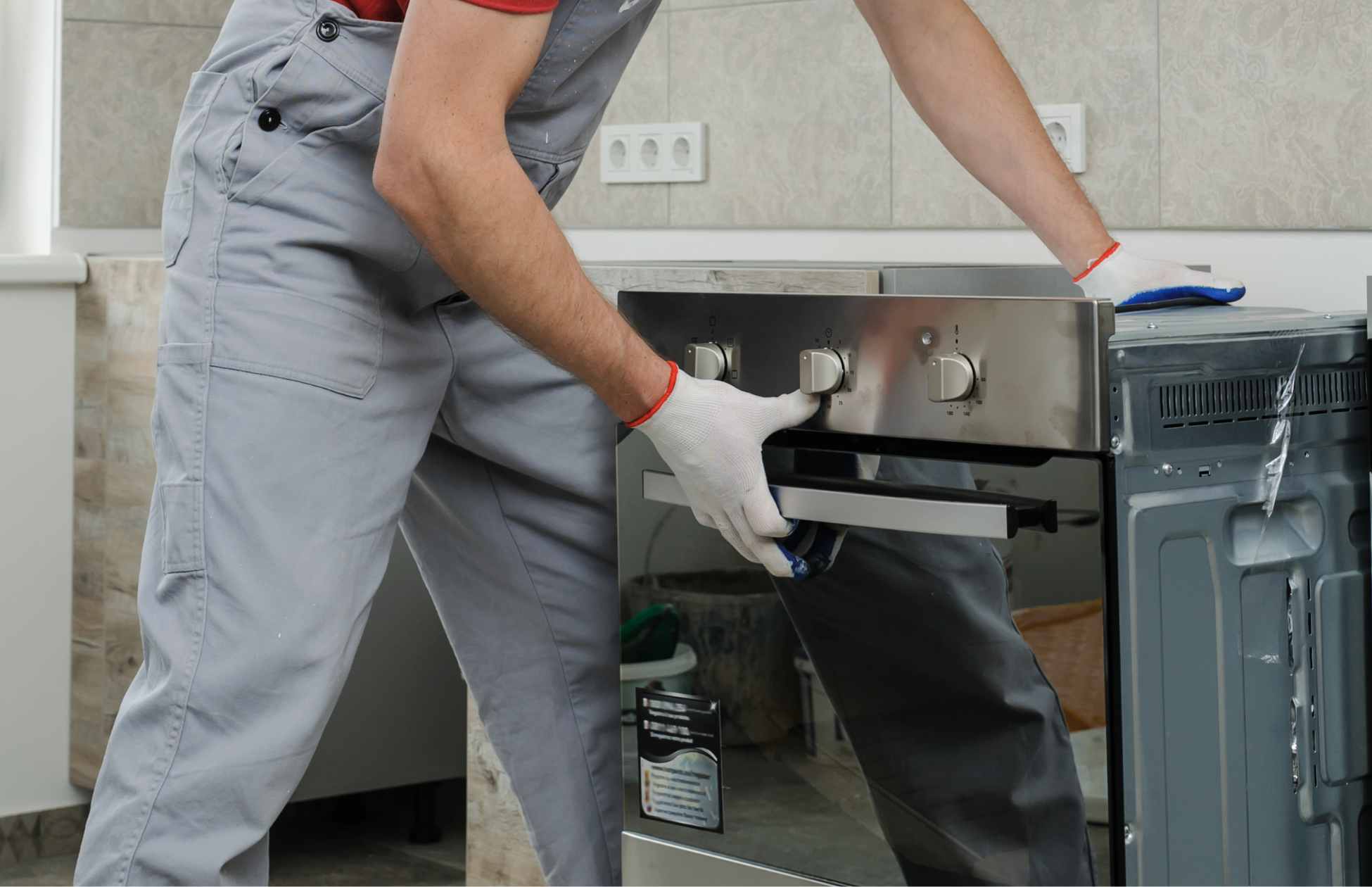

Step 4: Install the Electric Oven
Now that the space is ready and the wiring is verified to be in good condition, it’s time to install your new electric oven.
First, carefully slide the oven into the wall opening. As you do this, make sure not to pinch or damage any electrical wiring.
Once the oven is in place, use a level to make sure it’s perfectly horizontal. This is important for baking as uneven heating can affect the outcome of your dishes.
With the oven leveled, you can now secure it in place. Use the screws or bolts provided by the manufacturer and tighten them with your screwdriver. Don’t over-tighten as this could damage the oven or the cabinetry.
Next, connect the electrical wiring according to the manufacturer’s instructions. This usually involves matching wires by color and using wire nuts to secure them together. Make sure to tightly wrap each connection with electrical tape for added safety.
