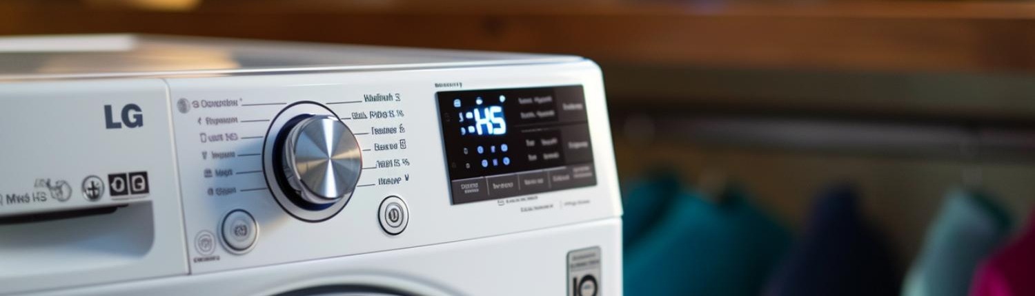

The LG dryer humidity sensor error code HS is a common issue that can occur in LG dryers. This error code can be triggered when the humidity sensor in the dryer detects an irregularity in the moisture levels during the drying cycle. When the dryer’s control board displays the error code HS, it typically means there’s a problem with the humidity sensor.
