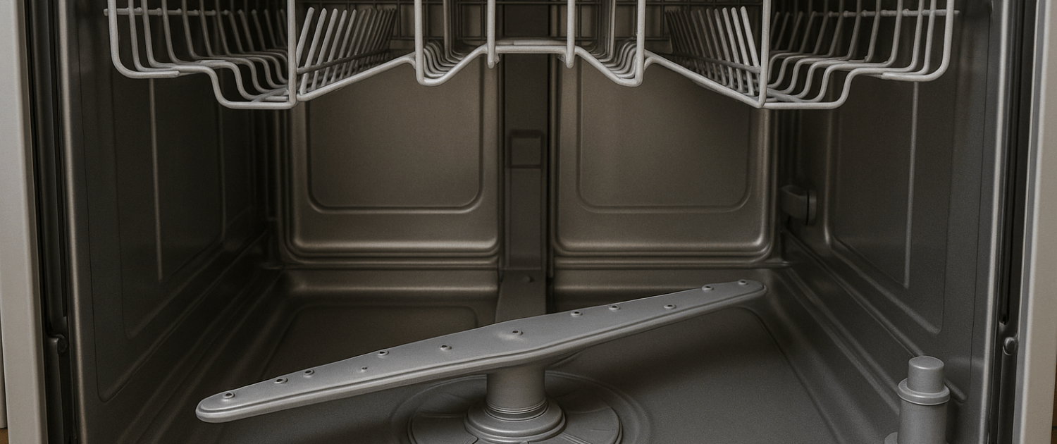

If your GE dishwasher isn’t cleaning like it used to, especially the dishes on the upper rack, the middle spray arm water tube (part WD21X20309) could be the issue. This part channels water from the pump to the upper spray arms, so if it’s cracked, clogged, or loose, your dishes might not be getting the rinse they need. The good news? Replacing it is a pretty quick fix you can totally handle yourself. In this guide, we’ll walk you through the steps to swap out the water tube and get your dishwasher back to work. Let’s get to it!
