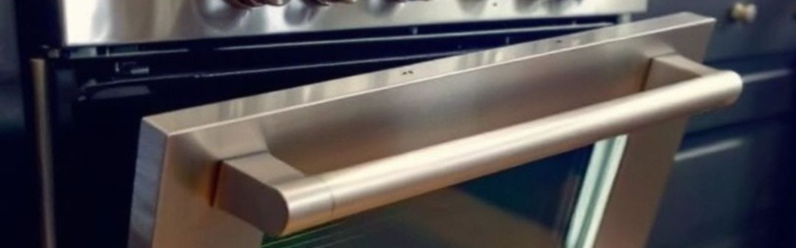

What to look for on the door
- Start by checking the door hinges for any debris or dirt that might be preventing them from closing correctly. Wipe away any debris you find.
- Open the oven door fully. Slowly lower it to see if it drops down without resistance. If the door falls freely, the hinges are likely worn out and need to be replaced. The door should lower smoothly and not feel too loose.
- With the door fully open, it should sit level. If the door is sitting below level, the hinges are likely damaged or misaligned and need replacement.
- Make sure the latch for the self-cleaning function is lining up correctly with the door. If the latch is stuck outward, it could be preventing the door from closing properly.
- If the door glass has been broken in the past, there could be broken glass in the hinge area. If this is the case, carefully clean it out.
- Check if the door seal, also called the gasket, is hard, cracked, or brittle. The seal should fit snugly around the oven door. If it looks worn out, it’s time to replace it.
