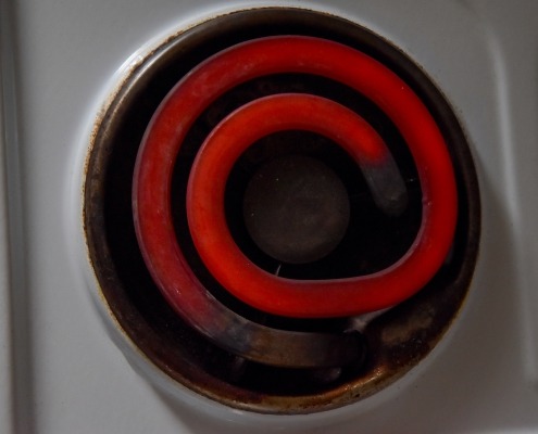

Why Your Range Terminal Block May Need Replacing
The terminal block is the part where the electric coils connect to your range’s internal wiring. Over time, the flow of electricity through these connections can degrade the metal contacts inside the terminal block. This causes poor contact between the burner and the wiring, preventing the burners from heating fully.
Symptoms of a failing ceramic terminal block include:
- Elements taking longer to heat up
- Elements not heating fully
- Elements heating unevenly
If you notice any of these issues, replacing the terminal block should restore proper functionality. With a few tools and safety precautions, you can swap in a new terminal block and be back cooking meals in no time.
