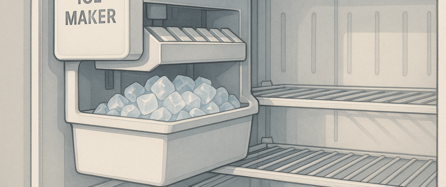

The icemaker assembly mounts inside the freezer compartment, typically on the top or side wall. It contains a mold with articulated arms to eject the ice cubes. A small motor, heating element, thermostat, and control module run the ice-making process.

Removing the ice bin or tray
The first step is accessing the icemaker by removing the ice bin or tray that sits below it:
  1. Open the freezer door completely to expose the ice bin or tray.
  2. Locate the release knob, arm, or lever at the front of the ice bin.
  3. Press down on the release mechanism while gently pulling the ice bin outward.
  4. Once loosened, lift the ice bin up and out. The bin may have vertical tabs that align with slots on the shelf.
  5. Set the bin safely aside and out of your work area.
With the bin removed, you now have access to the icemaker housing. Next, we’ll remove the cover.
